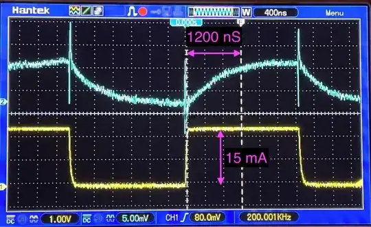

The OP asks:
how long does it take for an LED which is entirely off to get to its optimum brightness?
I tested a "normal, off-the-shelf" 3mm green LED from my parts box with a fast photodetector, and found it took about 1.2 microseconds to reach 90% brightness at 15mA:
scope trace showing LED brightness and current versus time
The upper (blue) trace shows the brightness of the LED and the lower (yellow) trace shows the current through it.
Notice how the brightness increases much more slowly than the current, even though the light emitted by a pn junction should change almost immediately with the current. Most likely this particular device therefore uses a phosphor to increase efficiency, and the rise and fall times of the visible output are dominated by the response time of the phosphor.
Note: For these measurements I drove the LED with a fast low-impedance buffer and validated the response time of the photodetector to be <10nS with a laser diode.
