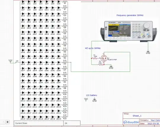

I need to blink IR LEDs at different Hz and I am going to use a frequency generator for that. The frequency generator is 30 MHz and that is the maximum I need to blink the LEDs.
I was thinking to use a MOSFET for that so I have a big 12 V battery and flick the LEDs on and off using the MOSFET as a switch with the frequency generator as signal to the gate. I understand that a normal MOSFET would not handle 30 MHz and therefore I need advice. The schematic is listed. It would work with lower frequency but not high.
The IR LEDs are going to draw 2 A.
Summary: I need something to act as a switch to switch power to the IR LEDs and a normal MOSFET would be good but not when blinking at the high frequencies.

    You will need a good gate driver between your function generator and MOSFET to accomplish that, and good layout and decoupling. – winny Mar 31 '21 at 17:03

    Also, are your LEDs that fast? You can drive them negative to offset any capacitive loading, but there will still be majority carrier recombination effects inside it which may persist for many nanoseconds. 30 MHz might not be obtainable. – winny Mar 31 '21 at 19:22

    Yeah, some infrared signal LEDs max out at 24MHz and those are designed for data transmission. You might need to sweep out carriers to speed up turn off. – DKNguyen Apr 01 '21 at 03:01

Can you do this? Yes, but not with your baseline setup. At the very least, the long wires implied by the schematic will cause all sorts of distortions to your drive currents, particularly ringing. If you really want to do this project, you are going to have to learn about low-frequency RF techniques, including cable termination.

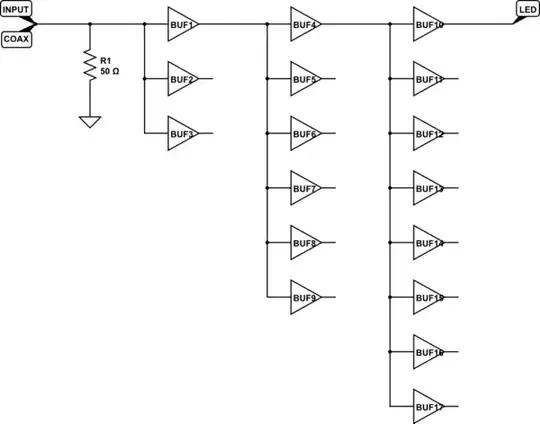

Instead of a single driver, you'll need a distributed setup. Start with a choice of ICs. In this case, your best bet would be to go with a fast, high-current logic family such as the 74F series. This has the useful characteristic that they can be bought at places like Mouser.com. This will draw 15 mA per output (which is a good match for your 140 LED/ 2A total spec. Propagation delays, including rise and fall times, are a max of about 5 nsec, which again is a reasonable match. In this case, the 74F244, an 8-channel bus driver would seem like a good place to start. Alternatively, there are even faster logic families available, such as the 74FCT.
A first cut at the system would look something like
schematic
Please note that ALL of the unused buffers actually get connected - I've just shown a single output for each of 3 levels. This approach will produce 144 outputs, each capable of a single LED.

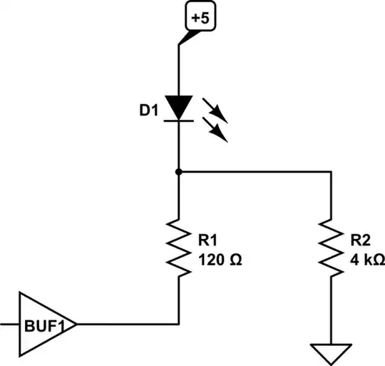

Furthermore, the "LED" connection must look something like
schematic
simulate this circuit
R1 limits the ON current of the LED, and for a 74F244 and 5 volts drive, something like 120 to 150 ohms will limit the ON current to about 15 mA. R2 will pull about 1 mA through the LED when the buffer output is high. This means that the LED will never turn completely off, but it will considerably speed up the operation of the LED - and you'll need it. You can adjust R2, and increasing it will increase the on-off brightness ratio at the expense of speed. Depending on exactly what you're trying to do, you'll need to do some experimentation to try to get the tradeoffs you need. Be aware that, if the buffers are exceptionally good, they will be attempting to hold their outputs high enough that the LED won't turn on, and you'll have to decrease R2 to the point that LED turns on. This will be a matter of experimentation, and you might get lucky - but keep it in mind, since you might not.

How much current will the supply need? Well, 2 amps or so for the LEDs. Plus the buffers. You'll need a total of about 20 chips, and about 2 amps for them, so count on a 5-amp supply.
