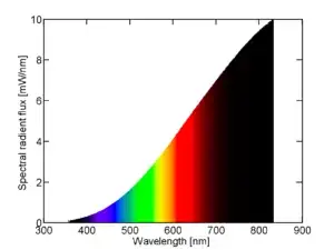

Bulbs
  • Light bulbs are resistors designed to glow white-hot when connected to the rated voltage. They can heat up to 2,500°C.
  • They behave like resistors. But like most metallic resistors the resistance increases with temperature. (This means that the temperature coefficient of resistance is positive – a PTC.)
  • When cold the resistance is much lower than running temperature so the initial surge current can be 15 times that of the steady state current. For example, a 100-watt, 120-volt lamp has a resistance of 144 Ω when lit, but the cold resistance is much lower (about 9.5 Ω). This is why incandescent bulbs are prone to blow on switch-on. A weakened filament will burn out with the high inrush current.
Figure 2. Spectral power distribution of a 25 W incandescent light bulb. out with the high inrush current.

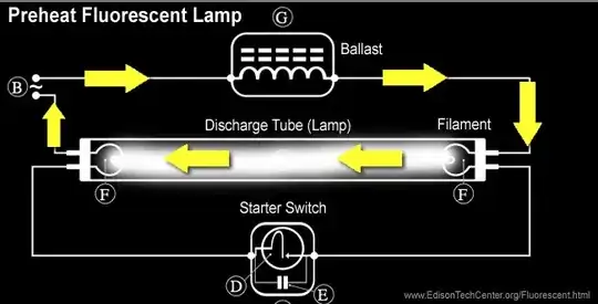

Fluorescent
Fluorescent light bulbs work by exciting a mercury gas to give off UV light. This light then hits the fluorescent coating on the inside of the tube or bulb. The fluorescent coating then "fluoresces" giving off visible light. The time delay is a result of having to heat the gas and strike it.
Figure 3. The fluorescent light circuit. Source: Edison Tech Center.
The link above is worth a read.
