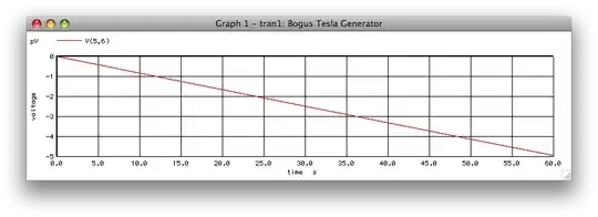

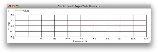

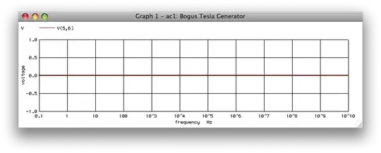

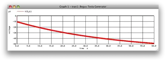

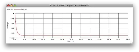

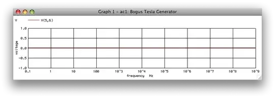

SPICE simulation:
Bogus Tesla Generator
Vin 1 0 0 SIN(0 1 34k 1ns 1e10)
C1  1 3 0.2u
C2  1 2 0.2u
C3  4 6 100u
C4  5 4 100u
D1  3 4 Dgermanium
D2  4 2 Dgermanium
D3  6 3 Dgermanium
D4  2 5 Dgermanium
RL  5 6 10k
.model Dgermanium D IS=200p RS=84m N=2.19 TT=144n CJO=4.82p M=0.333 VJ=0.75 EG=0.67 BV=60 IBV=15u
.control
delete all
tran 600u 60
plot V(5,6)
.endc
.END
34kHz was chosen for transient analysis almost arbitrarily, but it is the AC analysis that tells the story.
Vin: 1Vpp 34kHz signal, no load:
transient analysis, 1Vpp 34kHz, no load
(source: tyblu.ca)
Vin: 1Vpp 34kHz signal, 10kΩ load:
(source: tyblu.ca)

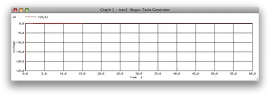

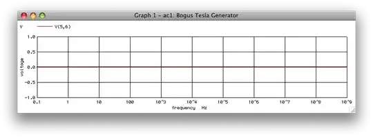

Let's check the AC response, from 0.1Hz to 1GHz, again with a 10kΩ load:
AC analysis, 1Vpp, 10kΩ load
(source: tyblu.ca)

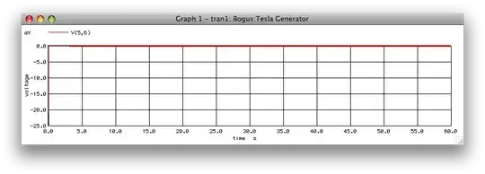

It's all floating, you say? Well, here's the results with node 4 grounded:
transient analysis, 1Vpp 34kHz, no load, node 4 grounded
(source: tyblu.ca)
transient analysis, 1Vpp 34kHz, node 4 grounded
(source: tyblu.ca)
AC analysis, 1Vpp, node 4 grounded
(source: tyblu.ca)

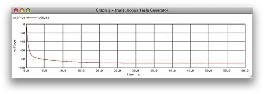

Although 1Vpp is massive to be floating around, what happens when it is large, such as standing in front of a microwave transmitter? (Other than the blocking caps blowing up.)
Vin 1 0 SIN(0 10k 34k 1ns 1e10)
transient analysis, 10kVpp 34kHz
(source: tyblu.ca)
AC analysis, 10kVpp
(source: tyblu.ca)
And with node 4 grounded:
(source: tyblu.ca)
AC analysis, 10kVpp 34kHz
(source: tyblu.ca)
Nothin'. Guess it doesn't work. Any corrections or suggestions are appreciated. Code is Berkeley Spice3 compatible'ish, but really isn't fit for anything, including merchantability.
