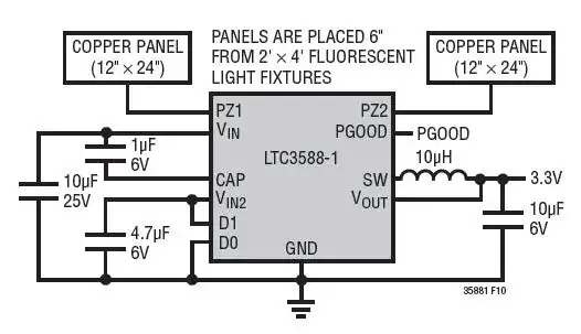

There's a neat chip called the LTC3588-1 which will let you harvest energy from a variety of sources (piezoelectric and solar being the primary uses). SparkFun has a breakout.
An example application circuit demonstrates harvesting energy from a florescent light fixture:
This specific application is in conflict with your statement of "I would like to make this as small as possible.", but it is an option to consider if you can't find anything else.
