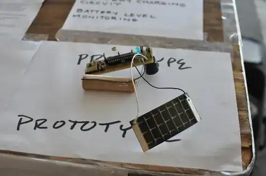

Rachel's Electronics has been posting about a solar-powered Arduino solution for remote sensors lately.
alt text
Not sure if that provides enough power for Wi-Fi, though. I'd look at less power-hungry wireless if I were you. Are you really sending 10 Mbit/s? Or do you just need a few kbit per hour?

    Also, only being picky because this site is young, but is the picture really needed? It doesn't add anything useful... Useful link though :) – Jon Hadley Sep 30 '10 at 19:40
    @Jon: It does. I'm learning and seeing things is invaluable. – Stefano Borini Sep 30 '10 at 19:56
    It shows the size of the solar cell and PCB (which was part of the question), the number of components, etc. – endolith Sep 30 '10 at 20:17
