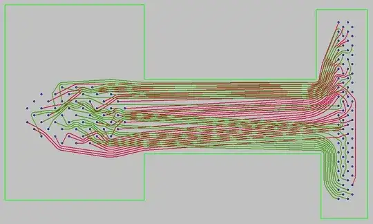

I've always wondered this: every single modern PCB is routed at 45 degree angle increments. Why does the industry prefer this so much? Doesn't any-angle routing offer more flexibility?
One plausible theory would be that the existing tools only support 45 degree increments and that there isn't much pressure to move away from this.
But having just researched this topic on google, I stumbled across TopoR - Topological Router - which does away with the 45 degree increments, and according to their marketing materials it does a considerably better job than the 45-degree-limited competitors.
What gives? What would it take for you personally to start routing arbitrary angles? Is it all about support in your favourite software, or are there more fundamental reasons?
Example of non-45-degree routing: alt text

  • @romkyns, The given example is the result of an autorouter, not manual routing. Many of the answers given apply only to manual routing (re: design efficiency). – tyblu Jan 16 '11 at 00:35
  • @tyblu I know. I still don't see any logic in claims that manual routing on the grid can be better quality than manual routing without a grid. – Roman Starkov Jan 16 '11 at 00:38

    @tyblu with crappy tools - maybe. I don't see why a good tool wouldn't let your tracks "snap" to minimum spacing you've set in your design rules. Seriously, I understand the argument that current tools suck at that, but not that this is an inherent property of no-grid design. – Roman Starkov Jan 16 '11 at 02:26

Fundamentally, it basically boils down to the fact that the software is way easier to design with only 45° angles.
Modern autorouters are getting better, but most of the PCB tools available have roots that go back to the DOS days, and therefore there is an enormous amount of legacy pressure to not completely redesign the PCB layout interface.
Furthermore, many modern EDA packages let you "push" groups of traces, with the autorouter stepping in to allow one trace to force other traces to move, even during manual routing. This is also much harder to implement when you aren't confined to rigid 45­° angles.

    Accepted. For the record, TopoR claims to be able to push groups of traces better than standard tools do - although I haven't tried myself. I take your point that it's harder to program arbitrary angle autorouters, but people have done much harder things... there just isn't enough demand for this somehow (and I still don't know why :D). – Roman Starkov Dec 19 '10 at 00:20
    Also, I've tried the TopoR demo, and it feels very "alpha" to me. The interface is very clumsy. – Connor Wolf Dec 19 '10 at 04:54

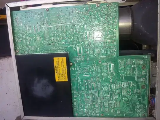

I don't think there exists such a strong preference for 45 degree angle. I have seen an old Tektronix Oscilloscope (Tek 2213 to be precise) board with traces that looks like hand drawn :-)
C--
  • 691
  • 18
  • 33
    The reason the traces look hand-drawn is because they are. The 45° preference thing is only common on computer designed circuitboards. Your tek scope predates computer PCB design, and as such the layout was indeed done manually (with tape, to be specific). – Connor Wolf Jul 30 '13 at 17:56
    @ConnorWolf: And we still complain about our PCB tools ;) Designing something like that without CAD is pretty impressive. – Rev Aug 03 '16 at 13:35
