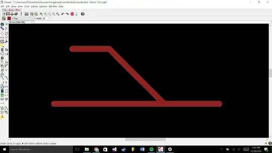

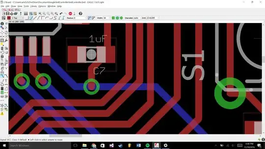

I was wondering if the complement of an obtuse trace would cause issues when routing, would it be better to have a 90 degree trace or one that comes in like this?
obtuse and acute
or 90 degrees
90 degree bend

    They are both fine. You have no acute angles because you came in by way of the corner. Judging from the picture. I didn't read the text very carefully. – user57037 Nov 10 '16 at 21:57
  • @ScottSeidman No this isn't a duplicate, I understand why to use 45 degree angles, in the first image I uploaded the trace is has an extremely sharp bend on the right, and a very open bend on the left – and3212 Nov 10 '16 at 21:58
  • @mkeith I am confused, what do you mean "way of the corner" and why does that make the acute angle not matter – and3212 Nov 10 '16 at 21:59

  • I prefer the upper picture. In the lower picture, the trace down from C7's right pad looks too close to the left pad. DRC may say it is OK, but I think it would be safer to take that trace straight down, particularly since there's ample space to do it. – Peter Bennett Nov 10 '16 at 23:16
  • In the lower picture (now that original is restored) there is not actually any acute angle because the trace enters the pad on the corner. If you entered at 45 degrees on one of the sides of the pad, then it would create an acute angle. It is OK to enter pads on the corner. But when traces fork, you should avoid acute angles. One way to do this would be to fork at 90 degrees. – user57037 Nov 11 '16 at 05:53

Generally it's good to avoid corners less than 90°. Note you don't seem to have a problem with the small 90° corners at left where a thinner trace leaves a fatter pad. Down to 90° is going to happen. Don't worry about it.
There are two issues here, acid traps and inductance. In some bad PCB processes, chemicals can get trapped inside sharp corners of the copper. This isn't going to be a problem if you use a competent board house.
A conducting path going around a corner has more conductance due to it acting like a coil. You can think of a 90° bend as a ¼ winding. Unless you have high frequency signals, this too is a minor issue. However, it's usually no big deal to use two 45° bends instead of one 90° bend, as you do in the red traces in the bottom of your pictures.
Remember that when hand-routing, you're not stuck with multiples of 45°. What I'd do for the case you show is to have the trace go straight from the via to the left-bottom corner of the pad. There is no reason for a bend part way like you show.
It may also be that in your bottom layout that the trace is too close to the left pad. Did you run a DRC check? It seems odd that all your traces are fatter than the minimum distance between traces. You expect power traces to be fatter, but signal traces are usually the minimum.

  • DRC says it is fine, why should they be skinnier, is 16 mil too big? – and3212 Nov 10 '16 at 22:47
    @and: 16 mil isn't too big if you got everything to route. It is bigger than necessary for most ordinary signals. I usually use 8 mil trace, 8 mil space design rules unless there is a specific reason not to. That's about as small as you can go but still have any board house in the world make the board without extra charges or chance of screwup, even with a sloppy process. – Olin Lathrop Nov 11 '16 at 11:40
