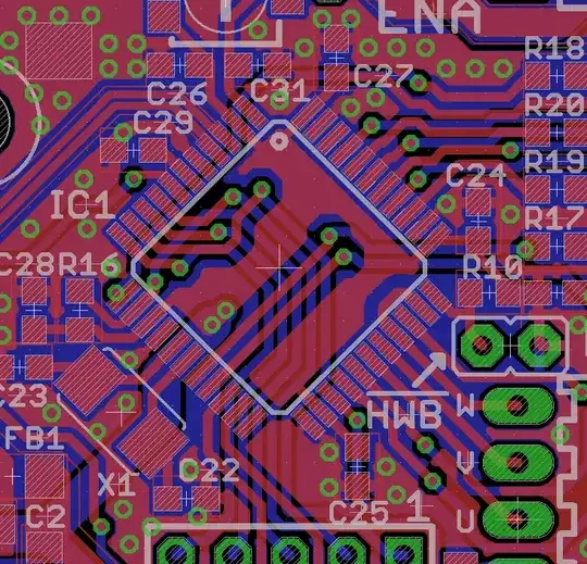

Now in some cases, especially TQFP or QFN packages, it is far easier to place them on a 45 degree angle. This actually makes escape routing much easier and more compact as you can go out easily in any of the 4 orthogonal directions after a short 45 degree trace. Notice how in the below image at the top right of the TQFP package, you can actually route the pins onto a 90 degree routing grid within the border of the IC.
Furthermore, some times space restrictions necessitate odd angles. Normally I would stick all passive resistors and caps orthogonally. In some cases, if for example a data bus with terminations is running on a 45 degree grid, it becomes necessary to rotate the passives to match to avoid increasing the overall size massively. Notice also in the image below that I placed the crystal at 45 degrees to match the TQFP package.
TQFP at 45 Degrees

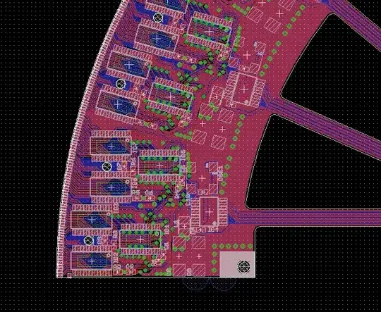

There are cases where I have put components on odd angles. However I only tend to do this if there is a very specific reason. One example is if you need to place LEDs in a pattern - for example edge mount on a circle. In this case it is necessary to put them on angles. I show this as an example below.
Example PCB
In fact you may notice that many of the components are rotated as well. This is indeed the case, and it is also another specific case. In this design, there are 11 copies of the exact same subsystem, each containing 32 degrees of LEDs in a circle. The individual sections were designed with all components but the LEDs placed orthogonally. 11 rotated copies were then placed to build up the circle. In this case components are not orthogonal over the whole design, but they are orthogonal in their sub-block.

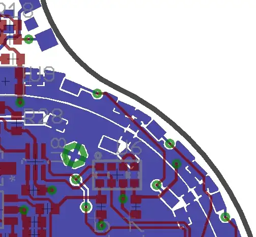

11
Some components are mechanically significant, as the O.P. have already gleaned. But majority of the PCB component (resistors, capacitors, small signal transistors, OpAmps, logic ICs) aren't mechanically significant. With these non-mechanically-significant components dense and convenient packing is often the goal. Most PCB components can be approximated with a rectangle. This is why PCB layout software defaults to right angle horizontal-vertical rotation.
Having said that, all PCB layout packages1 which I've used had a way of assigning an arbitrary rotation angle to any component. This is important for mechanically significant components. Automated pick&place assembly machines can place components at arbitrary angles as well.
On this board, most of the bottom (blue) layer components are at oblique angles. They are mechanically significant. All of the top (red) layer components are placed at right angles, because they aren't mechanically significant.
1OrCAD, Eagle, Altium. The layout in the illustration was done with Eagle.
