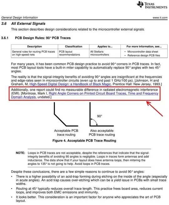

App note

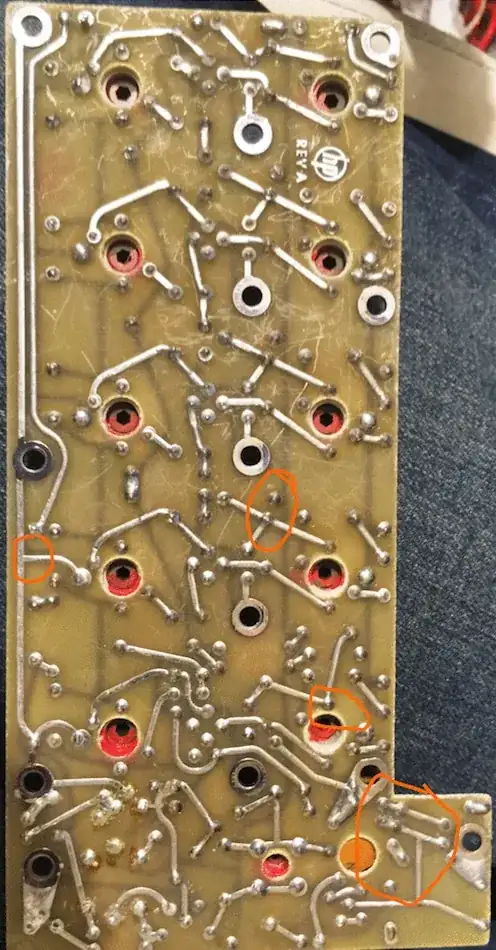

People may doubt my tradition argument, but I come bearing hard proof. I have a lot of circuit boards spanning times from the 60s to the present day, and it is clear that 45 degree angle traces are little more than an artifact of EDA software coming onto the scene and imposing arbitrary limitations (8 possible routing angles... computers struggled to do even simple vector graphics at the time, this made things easier).
First, here is a board for a frequency filter for an old HP synthesizer. This produced a lot of RF frequencies and used bazillion order filters, 24 of them, all carrying some multiple of 10MHz. This was a piece of HP test gear mind you, this was the state-of-the-art. It was made in the 70s, back when boards were still hand taped out. Boards of this era, even RF ones, never used 45 degree angles because their use was an artificial constraint due to software that didn't exist yet.
Right angles!
Let's flip it over...

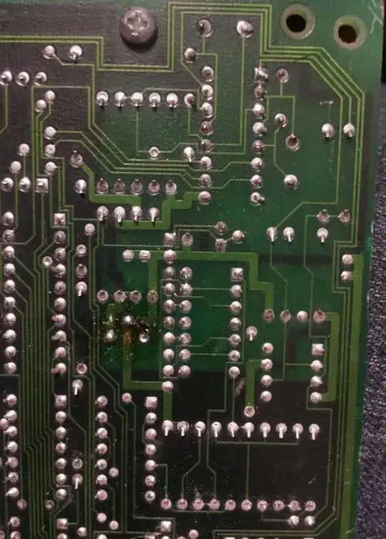

But those have lots of stuff rounded too...this was probably due to them being masked with rubylith cut by hand. Let's move forward to 1983, when EDA software was very much in use. Suddenly, all those curves and angles going any which way vanished, and only 8 directions were used. This is entirely because of the tools of the period, there was no design choice going on here. No one chose to only use 8 directions, they only HAD 8 directions to pick from in those early EDA tools. The following is a western digital disk controller from 1983.
Oh my... its as if they didn't care one way or the other about right angled or 45 degree trace corners. (Hint: they didn't.) They use both with wild abandon!
More close ups...
As you can see, it appears that the only real correlation between when one is used is that when needing higher routing density, 45 degree cornering is used much more often (though not always). This is the only concern that really influences cornering choice. Otherwise, use whatever you like. Clearly, this designer didn't particularly like either of them more than the other. He probably used to tape boards out, but has moved on to using EDA tools. He wasn't using 90 degree angles OR 45 degree angles on his traces before, and has no preference when he or she designed this.

    However, reading your text I remembered of a App note from Texas, that has discussing about layout from ESD supression. They have emission measurements that shows 45 degrees with a better performance than 90 degrees: http://www.ti.com/lit/an/slva680/slva680.pdf - bottom of page 4.
    What is your opnion about it? Does you think that the difference between 90d and 45d only appers just in the extreme high di/dt like ESD event?
