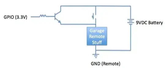

I'm trying to control my garage door remote with a GPIO pin from my Raspberry Pi. Instead of driving a relay, it would be much easier to just short the pushbutton on the remote. Is this how I should do it? Do I need a protection diode and if so, where should it go?
Does it matter that the 3.3V GPIO pin is referenced to a different ground (Raspberry Pi ground) than the remote ground?
Would also appreciate guidance on transistor to use and resistor value.
UPDATE; More info from comments by OP: After checking, you're right, the pushbutton simply shorts the circuitry to the return path of the 9V battery. My main concern is the 3.3V being referenced to GND while everything on the remote is floating.

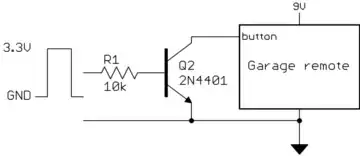

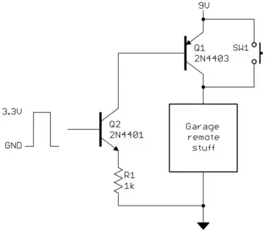

Right idea, wrong execution. Assuming your diagram of the remote is correct (I have no way of verifying and there could be a lot of different configurations), you want to use a PNP transistor. The NPN as emitter follower that you show won't work because the blue block will only see the 3.3V digital level minus the B-E drop.
That leaves a problem as to how to turn on the PNP. Here is a simple way:
Q2 will sink about 2.7 mA when the digital signal is high. Figuring Q1 should have a gain of at least 50, that will allow the block to draw up to 130 mA, which is probably a lot more than a garage remote draws. Adjust R1 accordingly if more current is needed.
However, are you really sure the button simply applies power to some block? That could make sense if there was only a single button, but is probably incorrect if there are two buttons, like open and close. My first guess would be that power is always applied and the button shorts some line to ground, although there could be a lot of different configurations.
Added:
You now say that the pushbutton doesn't turn on power to the unit, but shorts some line to ground. That makes more sense. In that case, this circuit should work:
The grounds of the remote and the computer need to be tied together, but there is no problem with that. The remote is a single isolated device, so there is nothing wrong with tying one of its nodes to some external reference. I see that others are making a big deal of this, but that is silly. There are cases where you want to isolate a switch like this, but when the device itself is arbitrarily floating as it is in this case, adding isolation is just a knee-jerk reaction or to satisfy religious beliefs.

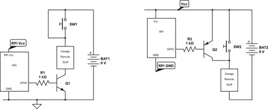

The idea behind your circuit is fine, the implementation requires some improvements:
schematic
You have two choices, I like the left circuit best:
  • LEFT: Short the switch and move the NPN transistor to the low side of the battery. This is most common way of controlling a load from a microcontroller. RPi's ground and the remote's ground are shared.
  • RIGHT: If you really want use the contact for the push button, which may mechanically easier to implement, then you need an PNP transistor and you want RPi's Vcc and the remote's Vcc interconnected. This may be tricky if an RPi has an on board voltage regulator. You need the 3V3 power supply rail of the RPi here. Also for this reason I would go for the left; it is more robust, simpler to implement. Actually I like Olin's solution better than the right circuit too.
Any cheap general purpose small signal transistor will work.
  • For left NPN eg.: BC547, BC548, 2N3904, ...
  • For right PNP eg.: BC557, BC558, 2N3906...
There are really lots and lots to choose from. Depending on your geographic location other part numbers may be more common. Just walk in a shop and ask for an equivalent of the ones mentioned above.
