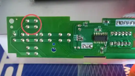

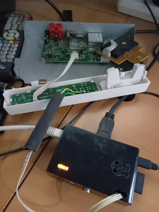

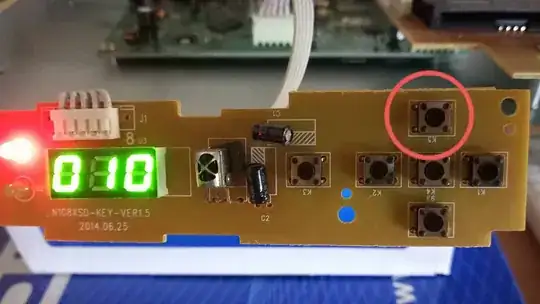

I have a TV decoder that I want to control the "UP" button with via a Raspberry Pi I have on hand.

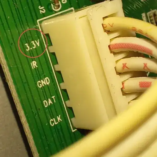

The "UP" button is a tactile button with 4 pins but I've learned already the pins work in pairs. The PCB has an input that says it is 3.3V so perhaps I won't need anything such as a relay between the Raspberry Pi GPIO pins and the PCB, but am I wrong? I do have a relay module if needed.
A commenter brought up another question which introduced me to the issue of having two-separate grounds which I wasn't aware to consider before and I believe I should add that the TV decoder is 12V but has a separate component (pictured below) that seems to be 3.3V. Not sure if this information changes anything.

Back side of PCB Front side of PCB Close up on connection to main PCB showing 3.3v

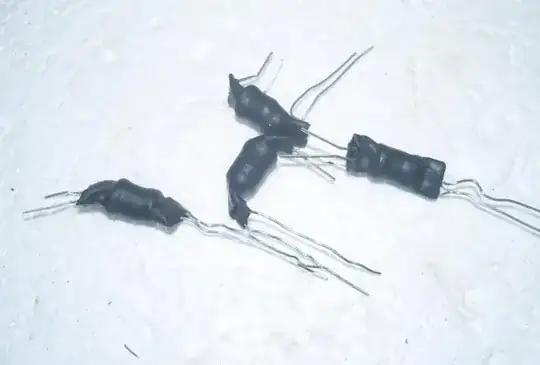

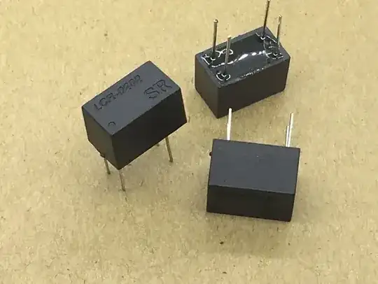

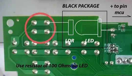

Use a VACTROL. Easy to use and also easy to make if you don't want to buy one.
Commercial variant: Vactrol
Home made with LED, LDR and schrink tubing: Vactrol homemade
Example Example
Benefits:
  • No need to mix circuits (does not require shared gnd)
  • No voltage or polarity issues
  • Completely isolated, cannot mess/blow up anything
  • Easy and safe!
How it works:
  • When pin is LOW, LED is OFF, LDR resistance is infinite (open contact)
  • When pin is HIGH, LED turns ON
  • When LED is ON, resistance of LDR is low (simulates a key press)
Codebeat
  • 1,326
  • 38
    I was having difficulty finding a PNP as recommended in another answer but did find a broken security camera and removed its LDR which does successfully flip the channel as you indicated. I will be constructing the LED interface next and appreciate your input since it seems to be the path forward for me. – Mike T Dec 28 '21 at 23:35

  • I do have a voltmeter on hand. When I press the button the voltage drops to zero otherwise the voltage is hovering around 0.80 volts. I'll go looking for a PNP then? Might I be able to recover one from another device lying around? – Mike T Dec 24 '21 at 00:44
  • Nearly any one will do. But 1st - what is the V on EACH pin when not pressed ? – jp314 Dec 24 '21 at 01:00
Seeing as the buttons and the 3 digit display are both controlled by the 16 pin IC the buttons must be matrixed with the LED display.
2 pins for power, 2 for communication 11 for the display, that leaves only one pin for the buttons! so the buttons are muiltiplexed with the display
Given that, the you need an isolated switch to drive the button signal.
Perhaps use an optocoupler (4N25 etc).
