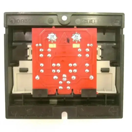

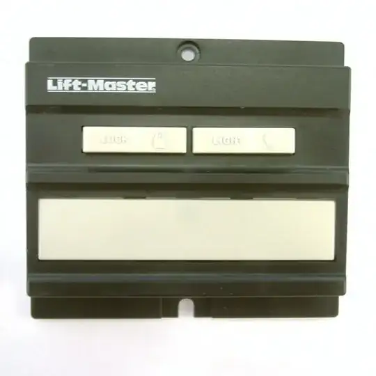

Note: I'm adding this as an answer, but just to get the photos from this eBay listing here (since they won't last). Looks like it might be resistors or diodes for the top two switches and the bottom switch just shorts the two terminals together. Maybe some LEDs on there too.
Easiest thing would be to pop the board out and trace it out. Very simple, in any case.
In case you're wondering "how" it would use resistors or diodes to detect the switch closures, the master unit would effectively measure the resistance for resistors, or flip the polarity and measure continuity. Obviously if the up/down switch is pressed it cannot detect anything else- no n-key rollover for you.
