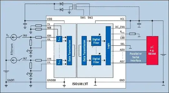

The Infineon ISO1I813T is the closest thing I've found so far:
Infineon ISO1I813T application schematic
The problem is how many external components it requires. With the same number of components, I think I can probably come close to its effect with the standard method. The only thing I lose is isolation, and I'm not sure I really need that. All I'm certain I need is protection.

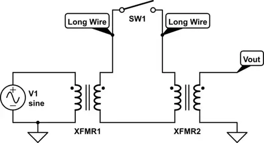

Maybe not low enough component count, but what about this?
schematic
It's isolated, within the limits of the transformers, and requires no power at the switch. The only real complications are generating and sensing the sine wave.
markt
  • 4,956
  • 15
  • 13
  • @WarrenYoung Look again. No power is required on the remote side. The MCU both generates the sine wave, and reads the received sine wave. – markt Jan 10 '15 at 12:19
  • So you put V1 in there just as a simulation aid? Shouldn't it be over on the other side, for clarity? – Warren Young Jan 10 '15 at 12:20
  • @WarrenYoung No, V1 isn't a simulation aid. V1 is the stimulus put into the system by the MCU. If the switch is closed, the stimulus can pass through both transformers and be received by the MCU; if the switch is open, then the stimulus goes nowhere. – markt Jan 10 '15 at 12:21
  • Oh, you're saying the µC is on both sides of this schematic. A PWM pin on one side, and the GPIO on the other, for example. And that's why you need two transformers: because you also have to isolate the two µC pins from each other. – Warren Young Jan 10 '15 at 12:23
  • @WarrenYoung You're getting it, but the two transformers isolate the switch from both MCU pins. – markt Jan 10 '15 at 12:24
    Two transformers is overkill. It can be done with just one. But while a transformer provides good protection against common-mode transients, it does nothing at all to suppress differential-mode transients. – Dave Tweed Jan 10 '15 at 13:22
