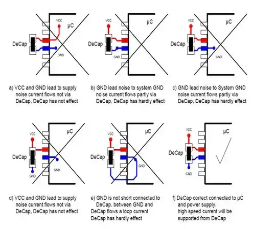

I searched a technology document about placement of decoupling capacitors and the main idea is shown in the following picture: enter image description here

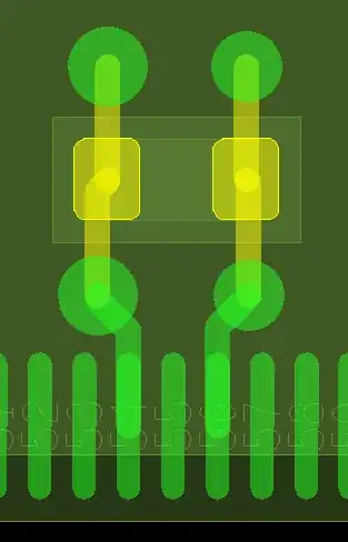

I think it is reasonable but do I have to put the decoupling capacitor and MCU in the same layer? it is not convenient for me to place other devices. So i choose to place the decoupling capacitor in the bottom layer
My PCB is a four-layer(signal-power-gnd-signal) one and when I split power and gnd layers the two vias closing to the pins of MCU in the above picture will not be included in net of power and gnd layer. Does it have the same nice performance as the case f in picture one? Do i have to take of inductance of vias in this case?

  • By trying to place your decoupling capacitor on the bottom side you have defeated the whole idea of having a direct no vias copper connection between the device pins and the capacitor. With the high switching speeds that occur in today's ICs this direct copper connection is more important than ever. Intervening vias add series inductance to the trace and effectively decouple the capacitor from the IC pin. – Michael Karas Jun 30 '13 at 13:31
    A lot of chip suppliers will specify how to decouple the chip you are using and apart from (e) the other methods will work for a vast array of devices whether on the same layer or not. However, for some devices the caps have to be camping on the pins virtually. The sort of device I'm thinking of is SMPS chips, hi-speed comms, rf devices etc.. Read the manufacturer's blurb - there's nearly always something mentioned on layout preferences. – Andy aka Jun 30 '13 at 14:13

    FWIW, I'm not sure I completely agree with the diagram in the first image. I would argue that A is actually the best connection layout, depending on what you are trying to do. A will actually decouple the power pins the most effectively, but it won't keep switching noise out of the power rails. F is less effective at decoupling, but it keeps noise out of the power rails more effectively. B and C are a mix of A and F. D and E are definitely poor layout, though. – Connor Wolf Jun 30 '13 at 14:38

  • @DavidKessner Assuming you only have the two lower V+/GND vias (and not the upper two 2 in the screen shot) you still have a problem with the inductance between the ground plane on the chip's die (bond wires+pins) and it's power plane (bond wire+pins). This is the main reason the recommendation is to have the cap connected on the same layer and close to the pins as possible before hitting a via. The uC is going to be the noise generator and getting capacitance to those two planes should take priority. – user6972 Jul 01 '13 at 03:01

  • @DavidKessner always on directly under the bga, no question. – user6972 Jul 01 '13 at 04:47

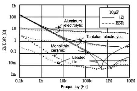

caps by type
You can use the SFR (self resonant frequency) to your advantage. If you have a problem with say a 1GHz clock leaking through, you can start by adding another bypass cap that is self-resonant a little higher than 1Ghz. 0402 10pF (from experience, not from the graph) are pretty self-resonant around 1Ghz.
Self resonance

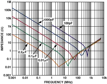

However this is only part of the story. What happens at higher frequencies? The mounted inductance plays a role and that is where the layout also comes into play between the layers in the board. For example a power layer and ground layer in the board with an SMD cap has the following mounted inductance loop model -- shown in red:
SMD inductance
In an example of 2 planes (power/gnd) in FR4 you can see that at high frequencies even the mounting of the capacitor can make a big difference. The black trace is without the cap. The blue and red show two different mounting topologies that show different mounting inductances.
The anti-resonances can cause more problems at high rates. And you might think you don't care about 1GHz+ noise, but the FCC might, and if you want clean edges on your digital 500Mhz signals, then you're going to need a lot of harmonics for that square wave. For example a 100Mhz clock to have a 0.5nS rise time needs at least a 900Mhz harmonic.

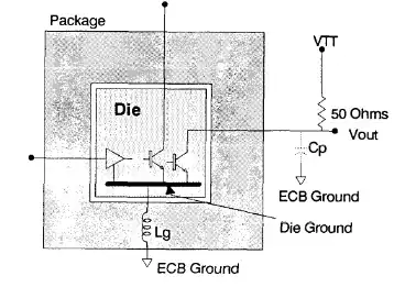

So what about the package itself? You've got output drivers, input pins, bonding wires, ground pins, power pins...(fyi ecb=pcb)
package
A full model would look something like this (including cross-coupling effects). The cavity plane is where the die would be represented. (Ignore the part with the Equivalent L+R for package Bypass Cap--that bit for a ic bonded with some on board bypass which isn't the case for this question).
model
Using microwave probes, a high frequency network analyzer and special TDR calibration fixtures the impact of the package both in terms of power/ground planes and cross coupling can be estimated.

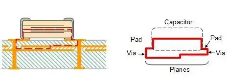

Your goal in placing the capacitor is to reduce the AC impedance of the supply rails. You want to do all of these things:
  • minimize resistance
  • minimize inductance
  • maximize capacitance
Assuming the trace lengths are reasonably short and thick, the resistance will be negligible relative to the inductance. Adding more capacitance is easy. Minimizing inductance is the hard part.
Calculating inductance exactly is complex, but there's a rule of thumb that's simpler: inductance is proportional to the area enclosed by the loop in which the current flows. Since at high frequencies, the inductance (not the resistance) of the power rails is the more significant impedance, your goal is to make sure the inductance through the decoupling cap is lower than the inductance through everything else. Ideally, by a large margin, since what you are essentially making is a filter that attenuates high-frequency noise generated by the IC to the power supply rails.

If you place C1 on the bottom, then you are adding more inductance at L3 by requiring the noise current to go through vias. It's worse than having it on the top, but is it good enough? It will depend on your application and how much noise you can tolerate.
If you are going to have four vias as in your proposed layout, it would be better to have all four connected to the power planes. Also, get them as close to the pads as you can, such that you don't even need traces to connect them. This will minimize the overall inductance. You don't need to worry about making the noise currents go "past" the capacitor. The inductance of the supply rails (L2) will force the high-frequency current to do that, since the rails are so much bigger and have so much more loop area. Instead, focus on minimizing the inductance to your capacitor (L1, L3).
Also, keep in mind that although increasing L2 would improve the filter, if you do it by moving the vias connecting the capacitor to the power planes far away (as in your example F), then you are doing it by including a loop antenna in your layout. This will give you worse EMI performance and worse ground bounce. If you must add impedance here, use a resistor or an inductor with low leakage. Rarely would I think this is necessary however: inspect some very high-speed layout like a PC motherboard around the CPU, and you won't find any L2 or R2 beyond what's unavoidable and intrinsic to the layout. If you are going to add another component, why not add another decoupling capacitor, which will double the capacitance, and halve the undesired inductances?

I had one PCB where the capacitors for the ADC were on the opposite side of the board from the ADC. I measured significantly less noise after I took off those capacitors and kludged added capacitors to the power pins of the ADC on the same side of the board. My understanding is that the improvement is entirely due to eliminating the via inductance.

  • the reason that i place the capacitor using pattern (4) is that noise from MCU can not go to power or gnd layer directly. they must go through this cap first. Does it have any problems? – oilpig Jul 01 '13 at 00:47
  • in addition, i have some questions about your loop from(1)-(4).the current should flow between power and gnd layer.so, (1):power-via-cap-MCU-via-gnd;(2)(3)power-via-cap/MCU-via-gnd;(4)power-via-cap-via-MCU-via-cap-via-gnd; (1)and(4)can isolate noise from MCU to POWER/GND, for convenience, i choose(4). – oilpig Jul 01 '13 at 01:01
  • I don't quite understand your question. Perhaps you could post it as a new top-level question, as recommended by "Do not post follow-up questions as answers. Ask a new question instead." – davidcary Jul 03 '13 at 22:46
