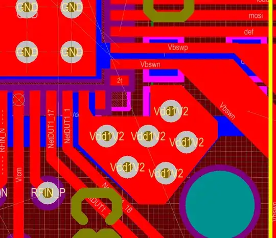

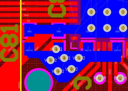

In order to connect my decoupling caps I have a forest of vias from the VDD pin to the other side of the board. On the other side, I connect the caps between the ground paddle and the vias.
However, in order to follow the rule of thumb above, I should not connect the vias to the ground plane. Instead, use separate vias to connect the cap to the supply plane.
This seems quite wasteful and odd to me. To make the long question short:
When placing decoupling cap at the other side of the board, is it ok to connect the power/ground planes with the same vias that connect the cap and the chip or should they be separately connected?
In order to give a precice example, this shows front and back layout:
Front Back
As can be seen, the 6 vias labeled Vdd1V2 also connect to the power plane Vdd1V2 directly. I do not have separate vias to connect the (then local) Vdd1v2 network on the back to the power plane.

  • I think you misunderstood my question. The picture should only support my question - it was taken from somewhere else. It is specifically about leaving the VDD connection local and connecting to the power plane afterwards vs. not. I updated the question with my own layout. I hope it's more clear now. – divB Feb 02 '18 at 07:45

  • I think you misunderstood my question. When connecting the VDD pin with the cap - that forms a local network. Now I can connect it to the supply in the middle of this local network or after the cap. As I understand from my referenced posts, the latter is usually preferred (it isolates the cap better from the supply). But when I use vias to place it at the bottom and these vias connect to power plane I automatically have the first option. I updated my question and hope it is more clear now. – divB Feb 02 '18 at 07:50
