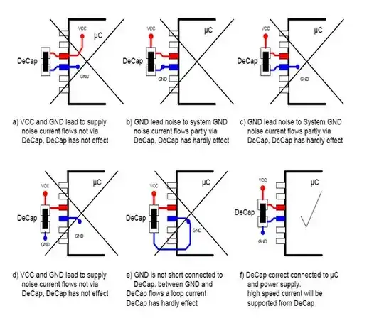

Going off of this guide, I understand that it is important that the current passes through VCC and GND directly through the capacitor.

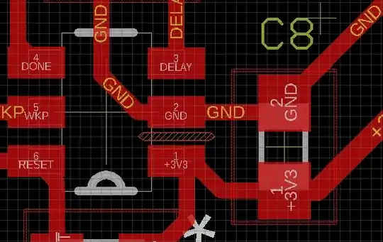

The route seems to correctly pass through the bypass capacitor before I add the pour.

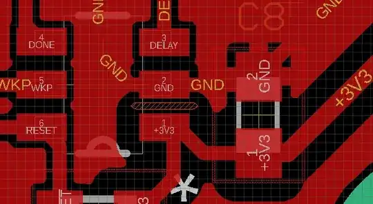

However, after I add the pour, now the current can circumvent the bypass capacitor. Does this make the bypass capacitor ineffective? Do I have to remove the ground pour from the VCC and GND pins when using bypass capacitors?

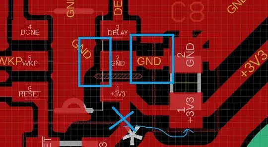

  • It would be helpful to see enough of the rest of the board to see where the C8 leads are going. Is the IC just off the page, or is it 15cm away somewhere on the other side of the board? It would also be helpful to know what the IC is, what else is on the board, what environment it will be working in, what frequencies will be present on the board, whether you have any transmitters, etc, etc. Designing a board is specific to the system - if you're looking to break general rules then you need to guarantee that your specific system can safely exempt itself from those rules. – J... Apr 08 '20 at 15:26
  • @J... The chip that it is decoupling is just to the left of the capacitor. – Ron Beyer Apr 08 '20 at 15:38
  • @RonBeyer Right - missed that. Still don't know what IC it is or what else is on the board. I'd definitely break the ground line running under the IC. The pour can go there but it shouldn't bond to pin 2. The pour should also not touch the trace between pad 2 of the IC and the cap. – J... Apr 08 '20 at 15:44

Your instructional diagram diagram is bogus for the most part (or at least, leaves certain rather important practical things unsaid). There's nothing wrong with A, B, C, or D (as long as D has a ground plane), at least until you get into the frequencies where everything is an antenna or transmission line. Adhering strictly to F and making concessions to do so can get you worse results until this point.

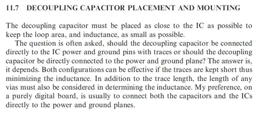

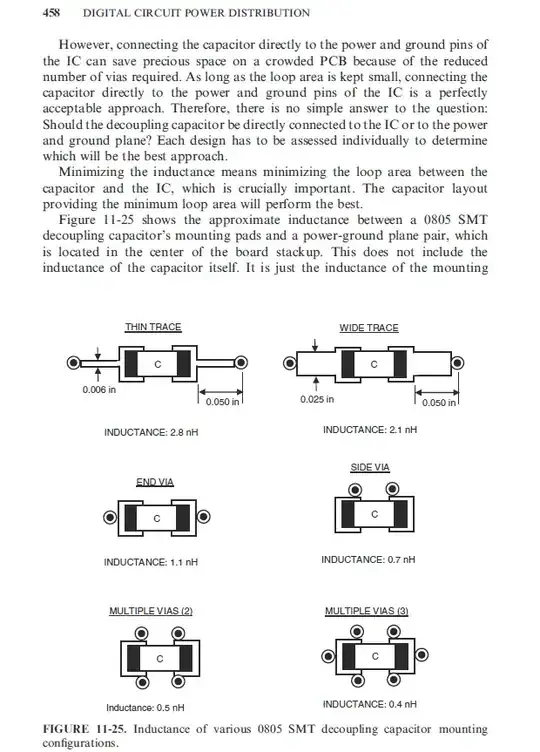

From Electromagnetic Compatibility 2009 by Henry Ott: enter image description here enter image description here

  • A is wrong because VCC is not going via the capaictor, B is wrong because the GND via comes before the capacitor, C and D same as B. Maybe, in alot of cases, it wont matter, just because circuitry is resistant enough do deal with it, but its surely not correct at all. – sgt_johnny Apr 07 '20 at 18:18

If you need to reject the most noise, follow the rules. Don't bond the ground pin to the pour under the chip. That plane is acting as a faraday shield - you don't want it polluting your digital reference level. Same with the lead coming from the capacitor - waves on the ground plane can also bypass the capacitor - break that bond there also.
On the 3V3 lead, don't daisy-chain from pin 1 on the IC - I'd back that up to pad 1 on C8.
We don't really know what IC you're using or what types of noise you anticipate needing to reject. If RF or microwave interference is anticipated and problematic then sticking to the design rules is probably a good idea.

It looks like you are using Autodesk Eagle according to the pictures. In this case, yes you have to remove the pour around the capacitor. This usually can be done by placing a line with a width of zero on the Keepout Layers.
If you are using thermal reliefs, like on the picture, this is very easy, you just can place a line on the thermals you don't want

    This is entirely wrong, the connection to the pour is much more preferable. The inductance of the connection is drastically reduced. – DerStrom8 Apr 08 '20 at 01:04
