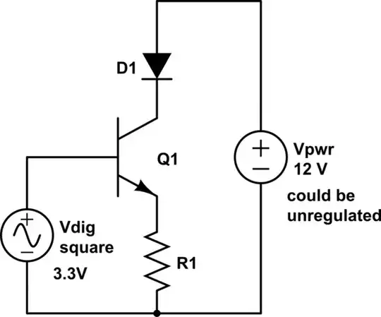

An even better variation on your option "B" is to put the LED in series with the collector, while leaving the resistor in series with the emitter.
schematic
This turns the transistor into a controlled current sink, where the current is determined by the base voltage, minus VBE, across the resistor. The base voltage normally comes from a digital output of a microcontroller, which is fed from a regulator, so its value is tightly controlled. For example, if you're using 3.3V logic, and have a 270Ω resistor, you'll get a nice 10 mA through the LED.
The anode of the LED (or even a long string of LEDs) is fed from a higher voltage (which doesn't even need to be regulated), and whatever voltage drop that doesn't appear across the LED(s) appears across the transistor.

  • I suppose I was considering cases where there is only a +5V supply available, but this is a good point, when a higher voltage than the logic is available. I suppose one could always add resistance to the base to make a voltage divider, too, and have the same part count as option A. – Phil Frost Feb 12 '13 at 22:40
  • @Dave Could you add a schematic showing your variation of option "B"? Would be helpful for the visual. – JYelton Jun 20 '13 at 22:16
  • @JYelton I just did. Hopefully I got it right. – Phil Frost Jun 22 '13 at 00:56
