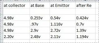

Follow up info #1 regarding figure #2. If I remove the resistor on the collector leg, the following is what is being measured: enter image description here
the Re in the table means after the resistor on the emitter leg
1- now I do not see emitter voltage = input voltage (even if I account for the 0.7v for the register-LED).
2- when I disconnect the collector leg, the LED actually is brighter.
3-when I reduced the collector voltage from 4.98v to 2.2v, I thought the emitter voltage would be reduced too.
So obviously I'm missing something regarding the common collector/emitter follower.

  • using arduino is what got me here in the 1st place. I was trying to drive a motor with 9v on the collector and 5v (or less) on the base. Transistor got real hot very quickly. So I figured I needed to step out of the cookbook and figure out how to really work with a transistor. Software developer turned hobby hardware??? Anyway further info regarding figure #2 posted above. I am using adruino as the power supply, two PWM pins for the collector and base. – user1683519 Dec 06 '13 at 22:49

  • @Wouter,actually, I found the common emitter config did better..due to an amplification? The experiment with the common collector (no resistor in series to the base or collector): I measured: collector = 5v(0.5mA), base=255mV (0.0mA meter showed), emitter shows 0.55v (0.5mA). When I completely disconnected power source to the collector, got even more interesting effect. At least with the common emitter config, results can be predicted? comments? – user1683519 Dec 06 '13 at 19:58
