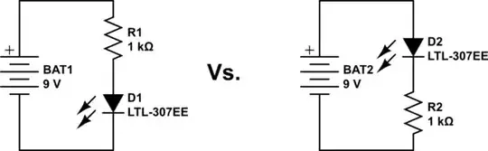

You don't need anything so complex as a transistor circuit to illustrate this; just an LED and a resistor will work. Try this:
schematic
Is there any functional difference between these circuits? If you really want to get into the cause-and-effect chain, then you need to think at the speed of light, and read How does the current know how much to flow, before having seen the resistor?

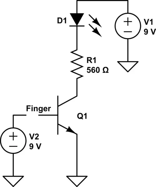

Perhaps it's a little easier if you think of the circuit as being drawn something like this:
schematic
Your finger acts as a resistor (a largely-unpredictable variable resistor), connecting the positive terminal of V2 to the base of the transistor. That allows a little current to flow through the base/emitter part of the transistor (both the emitter and the battery's negative terminal are grounded, so they're also connected to each other). The transistor then multiplies that current by some (more or less) constant factor, and lets that proportional current flow between the emitter and collector. Since that circuit also includes the LED, current flows through it, and it emits light.
Your schematic is basically the same, except that they've combined V1 and V2 into a single power supply. You simply need +9V in two places, so it connects both those places to the same power supply. The rest of the circuitry doesn't really care where that power comes from, or that the same power supply is being used in both the "input" side and "output" sides of the circuit.
In other words, the input circuit is basically the base/emitter, and the output is the collector/emitter. That's why this is called a common emitter circuit--the emitter is shared (common) between the input and output. There are also common base and common collector circuits, though common emitter is (no pun intended) much more common.
