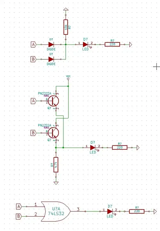

I am creating a circuit that will light an LED when either signal A or signal B is high. I know of three choices to accomplish this: a diode based OR Gate, a transistor based OR Gate, or an OR gate IC (Schematics below). Aside from minimizing cost and part lists, what are the pros and cons of each?

I am removing the BLUE LED and R5. I am removing the GREEN LED and R7. I want to light a single LED if either the input to the RED LED or the input to the ORANGE LED is high. I wasn't sure if just hooking both inputs to an LED without other circuitry was a good idea so I googled "OR Gate circuit" and discovered three possibilities: a Diode OR Gate, a transistor OR Gate, and an OR Gate IC. If any of these is the best choice, which is it and why? If none is best, then what is? I would like to reduce costs if possible.

I would say: none of the above.
Let's take them one at a time.
The first one you are assuming enough current from your logic outputs to drive the LED. You also need to take into account the voltage drop from the diodes. With silicon diodes that can be as high as 0.7V. It would work, and you don't need the 10KΩ resistor as it serves no purpose at all.
The second one the transistors are in the wrong place. They should be below the LED, not above it. The voltage to switch on is relative to the emitter, and with the LED and resistor in that path you're offsetting that voltage a lot. You should have the emitter to ground and the LED on the collectors. See my circuit below.
The third one I actually have no problem with, and if you want to use a chip then that's fine. Be sure to choose one that can source enough current to drive the LED.

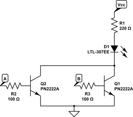

The discrete component option I would use would be to use a pair of NPN transistors:
schematic
With that arrangement the inputs aren't inverted (either HIGH turns a transistor on), and Vcc can be any voltage you like (with the right resistor and suitable transistors of course). The LED can draw as much current it needs to and isn't limited to just what the logic outputs can provide.

  • I think your comment about the first circuit is not correct. The 10k resistor is connected to ground, not a DC voltage. So the LED can only turn on from current supplied by either of signals A & B. If neither is present, there is no source of current to turn on the lED. – Barry Jan 02 '15 at 22:07
  • That's true, the way the circuit is laid out I just read that as going to Vcc since it was upwards - shows the importance of proper schematic layout doesn't it...? – Majenko Jan 02 '15 at 22:09
  • Also, your comment about circuit 3 is incorrect. 74LS (except for driver chips, and the LS32 is not one of those) will not source the required current. For driving 10-15 mA, LS will work only if the LED is sinking current from +5, not sourcing it to ground. In this case, that also means the gate has to be a NOR - such as a 74LS02. – WhatRoughBeast Jan 02 '15 at 22:30
    The second one will work fine. It eliminates the need for a base resistor at the cost of a (Si) diode drop across the B-E junction in series with the LED. (of course the pull-down 4.7kΩ resistor is unnecessary). The schematic you have drawn is missing the base resistors. – W5VO Jan 02 '15 at 22:31
  • Re option 3: I specifically mention to choose a chip capable of sourcing enough current. Re the circuit I drew: you're just fussy. I (and everyone with a clue) knows about the base resistors and take them as read. But just to please the pedant in you I have added them. – Majenko Jan 02 '15 at 22:38
  • The 2nd schematic in the question works just fine. In fact it's identical to the first, except the diodes have current gain. See Why would one drive LEDs with a common emitter? – Phil Frost Jan 03 '15 at 03:34

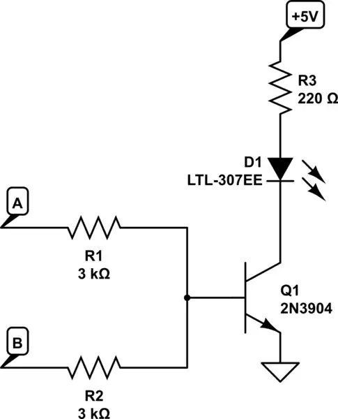

Here's an even simpler scheme that works if the input voltages are something like 0/5V or 0/3.3V:
schematic

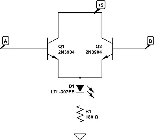

And if your input voltages are 0V/5V and you can even do this:
schematic
simulate this circuit
The solutions with transistors have the advantage that the inputs do not have to source enough current to operate the LED, only a mA or so.
