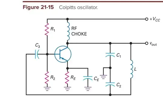

  • The typical explanation of a Colpitts oscillator in amateur radio literature shows a common-collector Colpitts, and describes the feedback as being C1/C2. And, for a high-Q tank circuit and low loading from the transistor, at the frequency of operation, $v_{be}$ is, indeed, pretty close to the ratio C1/C2 times the coil voltage. – TimWescott Aug 21 '20 at 15:49
  • @TimWescott a common-collector colpitts oscillator has gain due to the L and two Cs of $\frac{C1+C2}{C2}$. Maybe you can link an article? – Andy aka Aug 21 '20 at 17:55
  • @Andyaka, you're right. The caffeine hadn't kicked in when I made that response. By and large, though, there's a feedback that is determined by that voltage divider. I have no article to link to, but grab any ARRL Handbook from about 1975 to the present and you'll find it described that way. – TimWescott Aug 21 '20 at 18:15
  • And the ones from 1933 on will describe something similar, only with toobs. – TimWescott Aug 21 '20 at 18:15
    @Tim CC colpitts gain proof in my answer. – Andy aka Aug 21 '20 at 18:25
    Tim - I think, we do not need any handbook or link - we just have to look on the circuit and see the 3rd-order lowpass circuit, don`t you? – LvW Aug 22 '20 at 07:52
  • Tim - I must admit that you are right. The feedback factor (without consideration of the resistors) is app. C1/C2. I will elaborate this in my detailed answer...soon. – LvW Aug 22 '20 at 11:09

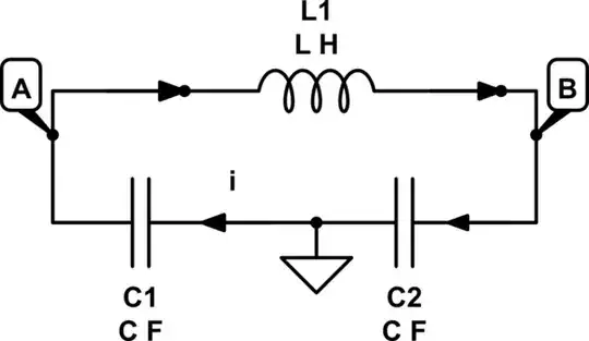

Consider an LC tank with node between the capacitors grounded as shown below:
schematic
You might know from basic electronics that if the capacitors have some initial charge, then the LC tank will start oscillating. Let \$v_A\$ be the voltage at node A and \$i\$ be the current through the capacitors then, voltage at node B, \$v_B\$, will be: $$v_B = i.\frac{1}{sC} = -v_A$$ Thus, the LC tank will have opposite voltages at its two ends A and B. In other words, between A and B LC tank has a transfer function \$-1\$. Due to the losses inside the tank the oscillations would eventually die out unless there is some positive feedback.

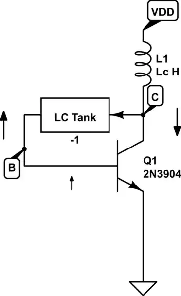

Now consider putting this tank across an inverting amplifier as shown below:
schematic
simulate this circuit
Since there are two inversions in the loop as shown by the arrows, a positive feedback is created which compensates for the tank losses and results in sustained oscillations.

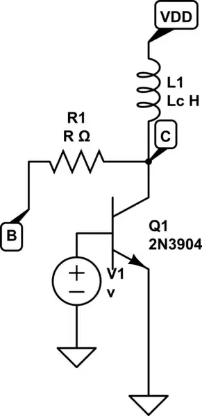

You might know that a real LC tank is modelled as a parallel combination of L, C and resistor R which models the tank losses. At resonance, the LC part has infinite impedance so the tank can be represented by just its resistance R. In this situation we have a circuit as shown:
schematic
Here I have broken the loop at node B to calculate the Loop gain. It can be easily calculated to be: $$L = g_mR$$ For oscillation buildup, \$L\gt 1\$, thus \$g_m \gt \frac{1}{R}\$.

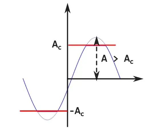

Suppose we have a system with clipping non-linearity as shown:
Suppose we give it a sinusoidal input with amplitude A and frequency f. As long as, the gain is less than the range of the clipping non-linearity (NL), the input comes out undistorted. For gain greater than the range of the NL, output will be clipped and the amplitude of the fundamental component will be given by: $$A_o = \frac{4A_c}{\pi}$$ The gain of the system at this frequency becomes: $$G = \frac{A_o}{A} = \frac{4A_c}{\pi A}$$
Thus the gain of the system falls at higher amplitudes.

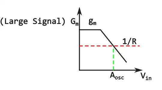

The transconductance of transistor actually behave quite similar to such non-linear system. Due to supply or current limitations and device non-linearity, the \$g_m\$ does not stay constant for all amplitudes instead starts to fall for larger amplitudes. For instance, in your case, the maximum current corresponds to \$I_{max} = \frac{V_{DD} - V_{CEsat}}{\omega L}\$. Above this current, the transistor ceases to be in active region. The \$g_m\$ can be plotted against amplitude and is shown below: enter image description here
It is easy to see the amplitude feedback now.
For amplitude smaller than \$A_{osc}\$, \$g_m \gt \frac{1}{R}\$ resulting in high loop gain and increasing amplitude.
Similarly, for amplitude smaller than \$A_{osc}\$, \$g_m \lt \frac{1}{R}\$ resulting in low loop gain and decreasing amplitude.
Due to this feedback created by the non-linearity of the circuit, the amplitude remains stable at \$A_{osc}\$, where loop gain is 1.
