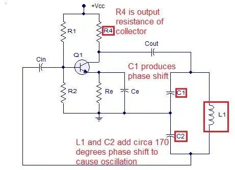

I've not found one online article that appears to understand the Colpitts oscillator (maybe I'll write one). Here's a typical schematic but it's impractically basic if you want decent sinewave purity. However, it does lend itself to analysis. The red bits were overlaid by me.
Collector current flows into R4 and, this signal can be shown to be a voltage source in series with R4 feeding C1 (Cout is too large to have any role and can be shorted).
So, R4 (the collector resistor) is the output resistance at the collector. It, along with C1 forms a phase shift network of a few degrees (circa 10 degrees but can be more). Then, the voltage on C1 feeds L1 and C2 - those are quite resonant and produce nearly another 170 degrees (sometimes can be less) at 1 particular frequency to satisfy the criteria for oscillation: -

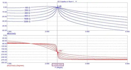

The Colpitts oscillator is a "near-resonant" phase shift oscillator. It relies on an RC phase shift AND an LC phase shift to produce a tenable overall phase shift of 180 degrees. It never works perfectly at LC resonance because you wouldn't get 180 degrees of phase shift. Here's a simulation of the RCLC circuit that achieves 180 degrees of phase shift and unity gain at 2.25 MHz: -
but that is not what I read from book. I am confused.
The simulation varies the resistance inherent at the collector node. Without the resistor, you will not get the required 180 degrees of phase shift but, you also need the resistor to give you gain at the collector so, you are stuck with it for two reasons and, for both reasons, the Colpitts oscillator will not work without it.
A lot of books/websites do talk a lot of BS when it comes to Hartley and Colpitts oscillators but, the simple answer is (as with any oscillator of this type), that it relies on phase shift to produce sustained oscillation.
