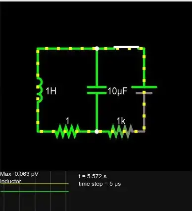

The first is a basic circuit with an inductor and a capacitor. When under constant power, the first scope shows there are no oscillations. When the switch is opened there are oscillations. From what I remember from class there will be some voltage on one side of the capacitor and the current will start to flow through the inductor. Inductors resist the change in current and as the electricity travels from one side of the capacitor to the other, the inductor will have a magnetic field built up. It continues to pull voltage from one side to the other until "all" (if resistance didn't exist) the voltage is on the other side. The process repeats in the opposite direction.

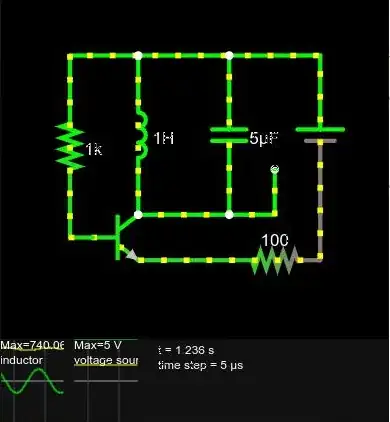

The second example is from an online circuit and it has been trimmed down so there is no amplitude modulations or frequency modulations, just a carrier wave. It is similar to the first circuit except there is a transistor in the mix. The 1st scope shows that there are oscillations. Now why this works, I don't really know. I'm suspecting that the base of the transistor is coupled in parallel to the inductor and it only allowing some extra current to "refill" the capacitor. However, the 2nd scope shows that this configuration is constantly pulling electricity through the transistor.(I'm sure a resistor could help slow this down some, but I want the circuits as simple as possible.)

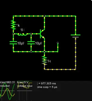

The third example is more complex. I know that the two capacitors need to be changed in pairs to adjust the frequency. The 1st scope shows that it has more voltage going through the inductor than the second circuit and the 2nd scope shows that the transistor only fires when it needs a boost. It appears that this is the best design. I have no idea how it works, but I will venture a guess since my goal it to understand it. I think as power comes it the left hand capacitor is "charged up". Once it is full, current begins to flow through the inductor. The voltage from the left capacitor begins to flow to the right capacitor. If resistance didn't exist I would imagine that this circuit might just oscillate forever, but somehow the transistor is supplying a boost.

  • With tank sine wave circuits, there is much more subtlety involved than just adding electric or magnetic fields; much more subtlety if you want to understand them. I would advise you focus on the colpitts oscillator. I've leave a link to see where you get to. – Andy aka Dec 07 '21 at 08:32
  • How does the Colpitts Oscillator reach a loop gain of 1? - this is a fairly extensive study of the colpitts oscillator with some math and (proper) simulations to underpin one of the main principles of ANY sinewave oscillator namely achieving a loop-gain of unity. Now this may be well beyond you so, start at the question above my answer and let's see if we can figure out a good and rationale starting point that makes sense to you and me both. – Andy aka Dec 07 '21 at 08:39
The circuits on 2nd and 3rd picture are oscillators used in old era.
The 2nd picture:
It's based on 100ohm series resistor voltage drop. Initially the transistor is open due to 1k base bias so L&C starts charging and voltage on LC tank is rising. During this the 100ohm drop is increasing.
Once the 100ohm drop is high enough the base bias isn't enough to further L&C charging the voltage on LC tank starts to decrease (the 100ohm drop also) and do an oscillation.
When the 100ohm drop is low again the base bias become significant (strong) from Ic point of view to charge L&C again.
