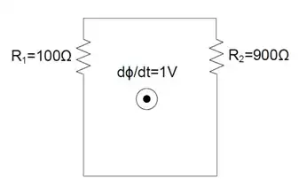

The circuit shown below consists of two resistors connected in series that form a closed loop. No electrical sources are in that loop.Let’s assume that the resistance of the wires that connect the resistors and form the loop is zero.Inside the loop is an external changing magnetic field that induces inside that loop a constant EMF of 1 V.
The current inside the loop is calculated using Ohm’s Law :

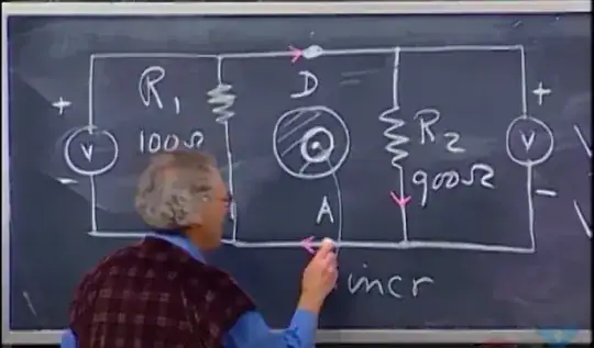

The problem was introduced by former MIT professor Walter Lewin. The problem was introduced in this video (starting at 35th min of the video): 8.02x - Lect 16 - Electromagnetic Induction, Faraday's Law, Lenz Law, SUPER DEMO
In the video is shown that two voltmeters connected to the same terminals show different values.
Can two voltmeters connected to the same terminals show different values?

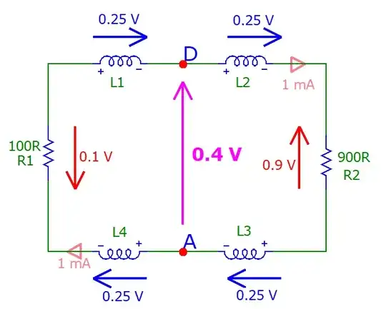

My solution to this problem would be:

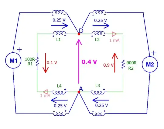

To measure the voltage between points D and A, the circuit has to be divided into two halves, the left half of the loop and the right half of the loop. If the induced EMF is considered to be equally distributed through the loop then in every half of the loop there is an induced EMF of 0.5 V:
The polarity of the the induced EMFs is according to Lenz law.

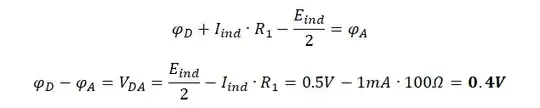

The voltage between points D and A by writing the equation trough the left half of the loop is:
The voltage between points D and A by writing the equation trough the right half of the loop is:
The conclusion is that there is a unique voltage value between points D and A, and the measured value should be 0.4 V.

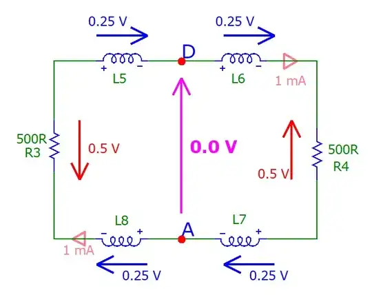

Now let’s connect to the circuit between points D and A two voltmeters. The two connected voltmeters together with the wires that connect them to the main circuit form a second loop. Let’s assume that the resistance of the wire that connects the voltmeters and forms the second loop is zero. The left half of the second loop is connected to the voltmeter between points C and B, the right half of the second loop is connected to the voltmeter between points F and E. There is also an induced EMF of 1V inside the second loop. If the induced EMF is considered to be equally distributed through the second loop then the final circuit can be represented with the model shown on below.

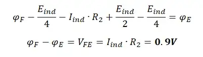

The voltage between points C and B is defined with the following equations:
The voltage between points F and E is defined with the following equations:
The calculations above match the measurement performed by professor Walter Lewin.

YES, two voltmeters connected to the very same couple of terminals can simultaneously show two different values. The reason is that, since the circuit path is enclosing a variable magnetic flux region, the 'theoretical potential difference' between point D and A is not (uniquely) defined.
Actually, that's all there is to it.
Because if your circuit sits in a variable magnetic field region, then all the paths between nodes sit in a dB/dt region, and since the line integral of the electric field along any closed path will not always be zero (this is basic physics), it is not possible to define a potential function such that the line integral of E from D to A only depends on the values in D and A. It will depend on the path. (This is basic calculus)

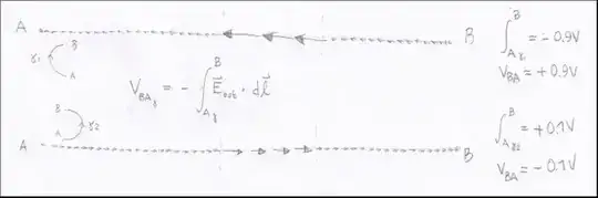

If the electric field is made rotational, as it happens in the presence of a variable magnetic field, then you can get different results at once for Vab, depending on the particular path you choose to compute the integral: you go along the path that passes through R1, you get 0.9V; you go along the path that passes through R2 you get -0.1V; you go along an arbitrary path that follows Snoopy's profile in and out of the conductor and resistors, you get 0.741V, you name it. (Note that I am not mentioning probes at all.) The endpoints alone are no longer sufficient to uniquely determine the voltage.
Here's the disambiguation between the two conventions I am going to use. Since it would be too much to use a different letter to denote path-dependent and path-independent voltage, I will use V for both, leaving it to the smalltext to tell them apart. So, Vab stands for
notation for path dependent voltage
and it's the energy per unit charge required to go from point A to point B along the path gamma(a->b). l will denote this, generally path-dependent , voltage with Vab, with lower case letters from start point to endpoint. When the electric field is irrotational, there is a potential function V such that
there exists a potential function
so that the line integral becomes path-independent and only the endpoints A and B needs to be specified, not the path gamma joining them (any path will do).
path independent voltage expresses ad potential difference
I will call this voltage 'potential difference' and will denote it with VBA, with capital letters ordered from endpoint to start point. Note: the endpoint comes first, since I adopt the convention VBA = VB - VA (graphically represented with an arrow going from A to B). This will further help in differentiate between the two.

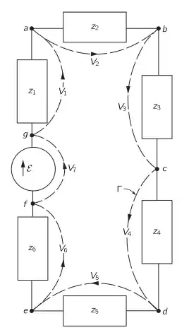

2 - Lumped Circuit Theory I : Kirchhoff rulez
Lumped circuit theory is so easy because it is based on this special, almost magical, kind of fields. The theory is so simple and beautiful that many engineers cannot let go of it and try to use it even when it is not applicable. The fundamental assumption of lumped circuit theory is that you must be able to define voltage between two points independently of the path. Considered the definition of voltage given above this means that
and in particular, if we choose a closed path of integration, i.e. a=b, the circulation of E must be zero
circulation in irrotational fields
It turns out that having zero circulation for the electric field along any closed path is a necessary and sufficient condition for the existence of a potential function. Now, since one of the fundamentals laws of physics, Faraday's law, states that
Faraday's Law integral form
it follows that if we want to be able to express voltage as a path independent potential difference, we must avoid regions of changing magnetic flux. Feynman is very clear about this in his Lectures: Volume II, Ch. 22, "AC Circuits" (emphasis mine.)
Suppose we have a circuit consisting of a generator and several impedances connected together, as shown in Fig. 22–9. According to our approximations there is no magnetic field in the region outside the individual circuit elements.
Therefore the line integral of E around any curve which does not pass through any of the elements is zero. Consider then the curve Γ shown by the broken line which goes all the way around the circuit in Fig. 22–9. The line integral of E around this curve is made up of several pieces. Each piece is the line integral from one terminal of a circuit element to the other. This line integral we have called the voltage drop across the circuit element. The complete line integral is then just the sum of the voltage drops across all of the elements in the circuit:
Since the line integral is zero, we have that the sum of the potential differences around a complete loop of a circuit is equal to zero:
This result follows from one of Maxwell’s equations—that in a region where there are no magnetic fields the line integral of E around any complete loop is zero.
So, KVL is just a particular special case of Faraday's law, when the electric field behaves in that magical way that will refill your gas tank when you go from the top of the mountain back to the parking lot. If your circuit path encloses a varying magnetic field then you are out of luck: the voltages in your circuit will not have unique values for the same endpoints but will also depend on the particular path along which you compute the line integral. But notice that Feynman says:

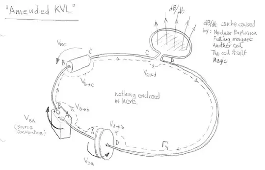

If we were to completely avoid regions of varying magnetic (and displacement) field, we would be stuck with simply resistive circuits. Let's see if we can work out a solution that allows for dynamic elements such as inductors (and capacitors) into the picture without giving up the simple tools represented by KVL (and KCL). Turns out we can, if we add the extra proviso that all the variable field craziness be left outside of the circuit path by confining it inside lumped components.
Leaving the variable magnetic region outside the circuit's path will allow us to define voltages in the circuit in an unique manner and use Kirchhoff laws to compute voltages and currents as we did with resistive circuits. By hiding the complexity of variable magnetic (and electric fields) inside the dynamic components, we can pretend that the voltage across them and the current through them still obey Kirchhoff rules, while in fact, deep inside, they are determined by the more general laws of Faraday-Neumann and Ampere-Maxwell.

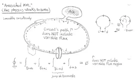

Let's consider the following circuit, with a generator, a resistor, an inductor, and a capacitor along the path that connects all their terminals together:
Lumped circuit with safe circuit path
The variable magnetic field regions are indicated by shaded regions and are relegated inside the magnetic element. The closed path can be decomposed into the following segments:
safe circuit path does not enclose changing magnetic field
Now, if - as it happens in this picture - the circuit's path does not enclose a variable magnetic field region, we can write the path integral of the electric field across the closed loop a-b-c-d-a and rest assured it is zero. This is the condition required to consider voltages function of the endpoints only, and for KVL to work (sum of voltages along a closed circuit is zero). KVL works because, by not enclosing any variable magnetic field in our circuit path Gamma, all voltages can be considered path-independent and it does not matter how we integrate from one terminal to the other.
But are all voltages in this circuit really all path-independent? Well, no. We just pretend they are by turning a blind eye at those that are not.

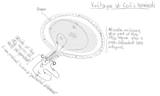

It turns out that when we come across the magnetic component, we can choose paths that go from one terminal to the other by entering or encircling the variable magnetic flux region. The voltage computed as a line integral along those paths will in general be path-dependent.

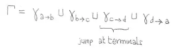

different paths joining the terminals - not all are safe Not all paths going from one terminal to the other give the same result, if we go inside the component
We can have paths from C to D crossing the region of variable magnetic field so that there are closed loops passing from C and D whose line integral is not zero. This means that we can have multiple values for the voltage between C and D. In particular there are different values for the line integral going from point C to point D in the space between terminal (say a voltage V) and another, different, value for the line integral along the path that follow the coil inside the conductor (and that value is zero).
There is hope, though. Among the infinite number of paths to choose from, those that do not go inside or around the forbidden region (like those indicated by \$\gamma_1\$, \$\gamma_2\$, and \$\gamma_3\$) all give the same result (in fact, by choosing them we always end up with an overall circuit path that will not enclose the magnetic variable region.)
So, if when we consider a path connecting the terminals we are smart enough to stay clear of the variable magnetic flux region, our circuit path will be in the clear, and - if we can delude ourselves that the coil voltage only depends on the endpoints (it does not!) - we will be able to use a mock-up version of KVL (much in the same way that jumping at the capacitor's terminals we can use a mock-up version of KCL)
stinks
Now, the problem is to find what is that one value of the path integral along any 'safe' path that goes from one terminal to the other without going inside or around the forbidden zone of the magnetic element. It turns out we can easily compute it by using - you guessed it - Faraday's law.

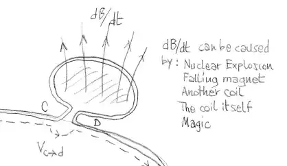

The fake 'potential difference' across a coil
We are going to consider this part of the circuit where we the value of \$B(t)\$ or \$\Phi(t)\$ is determined by the effects of a nuclear explosion, a falling magnet, another coil or even elven magic (but note that I am not considering the case of a moving coil - meaning we are in a frame of reference where the coil CD is at rest)

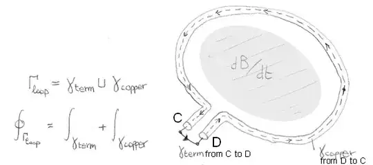

We are interested in the line integral along one of the 'safe' paths from C to D, that we will call \$\gamma_{term}\$. We can easily compute it considering it as part of a closed loop that encircles the variable flux region by going through the copper (so that the electric field has a known or easy to compute value and direction)
We can split the closed loop line integral into its constituent parts i.e. the path that connects the terminals from C to D (\$\gamma_{term}\$), and the path that goes through copper from D to C (\$\gamma_{copper}\$):
what we are interested in is the fist integral on the right hand side, that corresponds to the mock-up 'potential difference' at the coil terminals. We can find it right away considering that the circulation of the electric field across the closed loop has a value given by Faraday's law, and that the line integral going through the copper is zero because the electric field inside a stationary perfect conductor - even under the effect of induction - is zero:
and here is the result for our mock-up 'potential difference':
I put "VDC" in quotes because it is not a real potential difference, since in general this voltage depends on the path and not only on the endpoints C and D. But if we can make sure that we refer it to paths that do not get into or around the inductor's guts, we can pretend it is single-valued.
The voltage you see at the terminals of the inductor is the time derivative of the magnetic flux phi. The sign of the voltage depends on the orientation of the magnetic field and on how it is changing (decreasing, increasing) If you want, add that \$\Phi = L * i\$ (and in that case, since the magnetic flux is produced by the current in the loop itself, the sign of the voltage will follow from Lenz's law) or \$\Phi = M * i\$ (here the sign also depend on how you orient the coils) and you get the well known relations for self and mutual inductance. But this result is also valid for magnetic field changes caused by a falling magnet or a nuclear explosion.
Zero field in the conductor means no voltage build up inside the coil
Now, what it most interesting to us is that, despite the voltage presented at the terminals, the (total) electric field inside the copper conductor the coil is made of is zero. There is no 'incremental voltage build up' so to speak. All voltage appears at the terminals. This is how Ramo, Whinnery, and VanDuzer put it (p. 171 in the 2nd edition, emphasis mine)
"The voltage at the terminals of the magnetic element comes from the time rate of change of magnetic flux within the inductor, shown in the figure as coil. Assuming first that resistance of the conductor of the coil is negligible, let us take a closed line integral of electric field along the conductor of the coil, returning by the path across the terminals, fig. 4.2b. Since the contribution along the part of the path that follows the conductor is zero, all the voltage appears across the terminals."
How is it possible to have the path integral of the (total, see later expansion) electric field E be zero inside the coil's conductor, when we can measure a voltage at its terminals? Well, much like in the case of electrostatic induction, the charge that produces the field outside the copper is the very same charge responsible for making it zero inside the copper. In the electrostatic case the path integral is zero both inside and outside the conductor; in the quasi-static case of induction in a stationary conductor, the path integral is zero inside but non-zero outside.
two inductions
If you compute the line integral of the electric field jumping along a safe path from one terminal to the other, you get nonzero values (corresponding to the voltage that is given by the time derivative of the magnetic flux) because there is an overall non-conservative electric field in the space between the terminals, but if you compute the line integral from the same two endpoints by going inside the conductor, you get zero because inside the perfect conductor in these quasi-static conditions there is no electric field.
So, there you have it: multiple values for the voltage between the same two points in all your circuits using any form of inductor.
The trick we use in circuit theory is just to pretend not to see the infinitely many values the line integral can have if we choose paths inside the component's forbidden region, and only look at the nice paths outside of it that consistently give the same value. By forgetting that it is only one value among many, we call that voltage a 'potential difference' even if there is no potential function.
Now, if you were to make voltage measurements in your circuit you would get consistent results, no matter the path you choose as long as you stay out and do not go around the forbidden region inside the magnetic component. It is with this proviso that we can pretend we can still talk about path-independent voltages and potential differences. The working of your circuit is based on that illusory 'unique' voltage at the inductor's terminals. But if you put your probes around or inside the magnetic component, you will commit a probing error, because messing with the forbidden region will destroy that illusion.

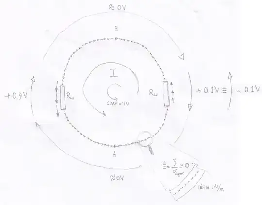

4 - The Romer-Lewin ring
In the Romer-Lewin ring two (lumped) resistors are placed inside a coil enclosing a variable flux region so that the circuit's path encloses a dB/dt region. Feynman is adamant: you cannot use lumped circuit theory. Lewin is also adamant: you cannot use Kirchhoff's law (it's for the birds!), so we need to go back to the more general relation: Faraday's Law.
If you accept that the variable B field will generate a rotational E field, things can be explained by looking at how charges in the circuit react to the induced field, change their configuration and produce a different resulting electric field inside and nearby the ring.
If you were to magically make the ring made of copper conductor and two resistors appear inside this circulating field, the charges inside and on the surface of its parts would almost instantaneously redistribute themselves in such a way as to obey Ohm's law.
We can get a glimpse of what drives the charge redistribution by considering the continuity equation. Charge displacement - gradients in charge density \$\rho\$ - happens on the surface also in the longitudinal direction, anywhere there be gradients in the values of conductivity and permeability. If we assume \$\frac{\partial \rho}{\partial t}=0\$, then the continuity equation becomes div j = 0 and by adding compliance to Ohm's law we get

Summarizing: if we consider the current density j to be the same along the whole circuit (by taking the conductor and the resistor of the same diameter, only differing in material), we will see a very small electric field inside the highly conductive copper (hence no distribution of imaginary partial coils voltages inside the conductor), a big electric field inside the the small resistor (responsible for the 0.1V 'voltage' along the path going through it, the sign depends on the direction) and a much bigger electric field inside the bigger resistor (responsible for the 0.9V 'voltage' along the path going through it). The sum of all voltages along the loop (note that they have definite values because I am specifying a path) is not zero, but it's 1V, as predicted by Faraday's law.
Romer-Lewin ring with fields and voltages along the circuit
Note that there are no probes in the drawing above. All voltages shown are single-valued because we are computing them specifying a path along the circuit (again, we have to specify the path because in non-conservative fields such integrals are path dependent). The fact that we find two different values of the voltage between A and B (namely 0.9V and -0.1V) is an expected consequence of the fact that the whole circuit path is enclosing a variable magnetic field region, and thus ordinary circuit theory is not applicable.
So the answer to your question "what is the theoretical voltage between points A and B?" is "it depends, along which path do you want it computed?".

    The values -0.1 V and 0.9 V are voltage drops across the resistors, but there has to be a induced voltage inside that loop that powers the current of 1mA. And I don't see why the voltage between D and A can't be defined in a given moment in time. So according to your theory the voltage in a turn of a transformer winding can't also be defined. This question is not About KVL , it's about the theoretical potential difference between points D and A. Please emphasize what the value should be. A much shorter and specific answer would be better, there is too much digression in your answer. – Slaven Tojić Jun 27 '20 at 05:58
    @SlavenTojic The answer to your question is in the first two lines: "Since your circuit path is enclosing a variable magnetic flux region, the 'theoretical potential difference' between point D and A is not (uniquely) defined." That's all there is to it. So, no, there is not "a" value (even if "a special value among the many" can be devised - in the part about the vector potential). If you think there is a 'distributed voltage' along the loop you are mistaken - even in an autotransformer, where you can 'extract' the voltage at any loop, the electric field inside the copper is zero. – Sredni Vashtar Jun 27 '20 at 06:14
  • Than why is there a current flowing. From where comes the current of 1mA – Slaven Tojić Jun 27 '20 at 06:16
    @SredniVashtar Thanks for making an answer of this. It hurts my brain to try and follow it but upvote for the effort. However, I'm with Slaven Tojic on this so instead of saying there is no value that can be devised for the voltage between D and A, maybe you can say what the voltage is between D and A when the voltmeter measurement is not subject to induction - as if it were placed vertically above the experiment and dead central to the flow of diverging field lines so that induction cannot happen. – Andy aka Jun 27 '20 at 08:32
    @Andyaka yeah, I know, it's difficult to let go of uniqueness of potential. But if you think about it this is what happens in every coil: if you look at the terminals from outside the path integral is nonzero, but if you go through the conductor it is zero. We just delude ourselves there is only one voltage by not looking inside. As for my answer, I agree it hurts the brain to read it: it's a medley of notes I made at separate times, with different conventions, it's full of repetitions and I have spotted at least two sign errors (fix coming). But the gist is there: there is no unique voltage. – Sredni Vashtar Jun 27 '20 at 15:32
    @SlavenTojic are you surprised you can have a current flowing in a perfect conductor that has zero voltage at its ends? This is what happens in literally every circuit. The current in the Romer-Lewin ring comes from induction: the changing magnetic field causes the rotating electric field that causes charge displacement that result in an equilibrium where there is a current of 1 mA flowing through the ring and different voltages (computed along the path inside the resistors) across the resistors. No voltage drops on the perfect conductor joining them. Pretty crazy, uh? But that's the way it is – Sredni Vashtar Jun 27 '20 at 15:49
  • @SredniVashtar Your answer is too long, to many digressions. If you really understand this problem you can explain it in a more shorter and simple way. The main questions are: Why you can't model the loop inductance as an inductor and place it in the circuit. Why is the professor measuring two different values. My and Andy aka solutions are explaining why he is measuring those values. I will be glad to learn something new. It's good to be open minded to new ideas. I posted this question because it wasn't logical that two voltmeters are measuring different values – Slaven Tojić Jun 27 '20 at 17:30
    @SlavenTojic The answer, as I said before is in the first two lines. There really is nothing more. The digressions, I concur they are lengthy and boring, but IMBO are necessary to clear the many objections that usually come up when those two lines need to be digested. I also had a digression about the transformer and how you can tap it ad different coils to get a different output voltage when inside the total electric field is basically zero, but I did not put it in. And you came up with that question :-). Things might get clearer when I get to the vector potential and the McDonald maneuver :) – Sredni Vashtar Jun 27 '20 at 17:38
  • @SredniVashtar there has to be simple explaination why the voltage is not defined. You can't just say it's not defined, it is the way it is. To quote Albert Einstein : If you can't explain it simply, you don't understand it well enough. – Slaven Tojić Jun 27 '20 at 18:06

    @SlavenTojic I added one last image that should address your doubts about how a transformer can produce a voltage at its (open, in this case) terminals, when there is no voltage buildup inside the coil's copper. You might want to read Purcell (Berkeley), but also Haus & Melcher (MIT) or try to find Arias's lessons (Cornell) on YT. Purcell and Haus also feature the very same experiment made by Lewin and they agree that the correct interpretation is that voltage is not uniquely defined. (Nonuniqueness of Voltage in an MQS System: http://web.mit.edu/6.013_book/www/chapter10/10.0.html) – Sredni Vashtar Jul 13 '20 at 02:09
    @SlavenTojic Ok, I fixed (at least the origin and end of) the field lines. They are not simulated, just sketched on the fly. If you wanna see the actual field lines in the inner part of a coil, you can find it on the Haus and Melcher textbook mentioned above. (one final note: the ideal transformer is an idealization that has infinite self-inductance - not the case of the single turn Romer-Lewin loop. What I model here is the real transformer (if we consider the primary coild producing the flux), without losses and with negligible self-inductance because that was what is used by Lewin). – Sredni Vashtar Jul 14 '20 at 04:07
    If you actually simulate the field, you will find that in the electrostatic case if you compute the path integral along a path from one point to another of the conductor surface in the space around it, you find yourself going against the E field in the first part, along the field in the middle and against the field in the last part. The result is a zero path integral, as expected in the electrostatic case. In the MagnetoQuasistatic case, instead, the paths from one terminal to the other outside the conductor will have a dominant part that go along or against the field giving a nonzero voltage. – Sredni Vashtar Jul 14 '20 at 04:51

The actual circuit in the question is this: -
Small print added 27th June 2020
  • Lewin states that the flux is linearly rising at a rate that induces 1 volt in the loop (I call this the "main-loop").
  • I am also assuming that all the returning field lines flowing back to the flux producing coil are outside the loop formed by R1, point D, R2 and point A.
  • I am also assuming that the measurement devices M1 and M2 (shown below) do not affect nor are affected by the magnetic fields
  • I am also assuming that M1 and M2 measurement wiring (to points D and A) take a path that is very close to the path of the main-loop i.e. they receive the same level of induction as the main-loop
In other words, with 1 mA DC flowing around the loop due to a linearly increasing magnetic field, the voltage across R1 has to be -0.1 volts and the voltage across R2 has to be +0.9 volts. This cannot be disputed. I've added signs to the values now to make this clearer.
The difference in voltage seen across the two resistors is because every point in the loop has inductance (including the resistors) and this is a distributed inductance hence, the induced voltage is also distributed and this means there is a volt drop in the wires that connect the top of R1 with the top of R2 and ditto the lower node. That accounts for the voltage difference: -
  • L1, L2, L3 and L4 represent the inductance that receives induced voltage and I've split it into four quantities for ease of understanding
  • If you measured (with care) directly between points D and A you would measure 0.4 volts (previously I said 0.5 volts but that was a \$\color{red}{\text{stupid error}}\$).
  • If you go round the loop looking at the induced voltages (in blue) you will see that the total induced voltage is 1 volt (4 x 0.25 volts).
  • That induced 1 volts drives 1 mA through the total resistance of 1000 ohms. (Current shown with pink arrows)
  • The voltage across each resistor is as indicated because \$V=IR\$ and, we can assume that the physical length of each resistor is so small that we can neglect a few milli-volts induced across each resistor that would slightly decrease their local IR volt drops.
Because the video experiment is inadequately defined, it's hard to be sure but, assuming the measurement nodes are exactly at points D and A (as opposed to directly across each resistor), then the measurement loop serving R1 will indeed reflect the -0.1 volts seen because the measurement loops are just as vulnerable to induction as the main current loop.
It's the same for the measurement loop serving R2: -
  • So, M1 will read \$\color{magenta}{\text{0.4 volts}}\$ minus twice 0.25 volts = -0.1 volts
  • And, M2 will read \$\color{magenta}{\text{0.4 volts}}\$ plus twice 0.25 volts = +0.9 volts
If you can't see this easily, think about the + terminal of M1. It has to be 0.25 volts lower than point D, Whereas for M2, its + terminal has to be 0.25 volts higher than point D. Similar story for the meter - terminals relative to point A.
And, for the case when the two resistors (now called R3 and R4) are equal values of 500 ohm, if you could measure directly across D and A, I believe you would measure 0 volts: -
  • M1 would measure -0.5 volts and
  • M2 would measure +0.5 volts
Prior to today's modifications I was getting in a muddle about this but now it's clearer. It didn't help that I made the mistake of calculating the wrong voltage across D and A in the first example - that threw me and it took a couple of days to sink in and see the obvious. Memo to myself - Always double check stuff!

    @Andyaka I am surprised you tried to apply Kirchhoff's rules where they do not belong. You should think again about this problem and the concept of 'partial' or 'distributed' inductances. Have a look at how they treated this problem on physics stack exchange, or at the less voted comments in Electroboom's youtube video channel (try those by Trevor Kearney, he's repeating them often, so they are easier to find). The potential just isn't uniquely defined. – Sredni Vashtar Jun 26 '20 at 16:38
  • @SredniVashtar why the fixation with Kirchoff? I didn't think about Kirtchoff at all when solving this - if you think it's wrong and physics SE shows it then please link - I'll be happy to take a look. BTW I'm not disagreeing with Lewin's electrical observations. – Andy aka Jun 26 '20 at 17:41
  • @SredniVashtar Do you mean this question? – Andy aka Jun 26 '20 at 17:47

  • @SlavenTojic in the Lewin ring with resistors the charge that has been displaced by the induced rotational field will accumulate at the resistor's boundaries, giving rise to the strong electric field inside them and, by superposition (between the induced and coloumbian fields generated by interface and surface charges), to the resulting small E = j / sigma field directed along the conductor in the verse of the current. In an uniform resistive ring you have to imagine the resistors as distributed along the length of the ring so that the only resultant field will be E = j / sigma. – Sredni Vashtar Nov 11 '20 at 13:34
