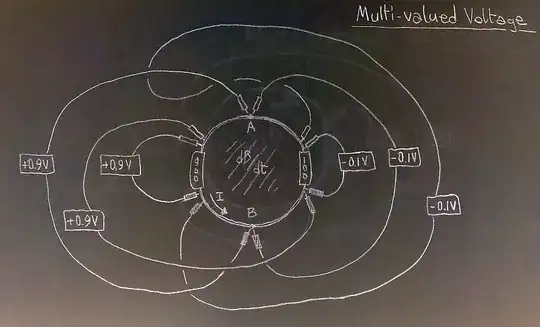

To illustrate why it is so, I will use without loss of generality a simpler circuit with only two resistors that I will call Romer-Lewin's ring.
multivalued voltages
The key to understand what 'voltmeter on one side' means is how you go from the plus to the minus via the probes, in one case is clockwise, in the other is counter-clockwise (note that this is a negative of a sketch on paper, so the positive lead is the empty one, while the negative lead is the filled one)
The following figure is even more striking: if you constraint the probes to slide on the ring and you are not allowed to detach the tips, you can slide the tips along the ring to touch the resistor terminals on the other side and read the same voltage
slip slidin' away

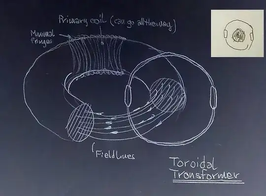

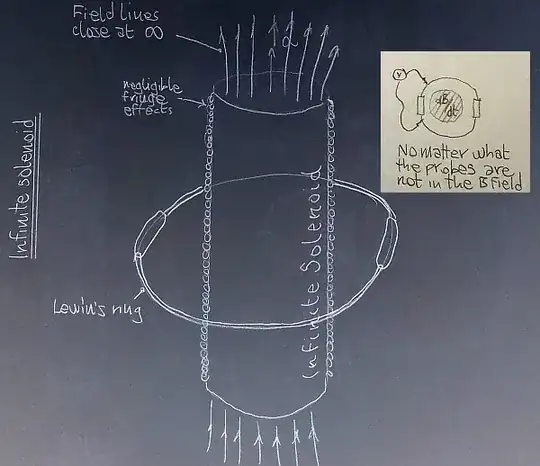

The Experimental Setup
You can test the above assertions with a reasonably big toroidal transformer and three resistors soldered in a ring around the core. I say 'reasonably big' because the key is that you should not be able to 'kind of lump' the variable region in an isolated part of your circuit. Make sure the resistors cannot 'see' each other due to the core being in the way (the reason for this is explained later on). Something like this:
Toroidal transformer
In this picture a part of the core is not shown to make the field lines visible. I use the word 'transformer' because I did the experiment using a toroidal transformer.
For simplicity, since I already have many pictures done for explaining Lewin's superdemo, and because the underlying physics is exactly the same, in what follows I will be using a circular ring with only two resistors. This has two main advantages: first, it does not introduce any distraction on the real purpose of the experiment, i.e. demonstrating that voltage depends not only on the endpoints but also on the path along which you need it evaluated; and second, the symmetry will simplify the math to the point that we can find the actual fields involved with relatively little effort.
I see from the comments that you are wondering about the 'return field lines' of the B field. Well a toroidal set up basically confines almost all the lines within the core, so that you won't have to worry much about intercepting them with your probes. Lewin uses a long solenoid that is an approximation of an infinitely long solenoid, whose field lines close at infinity, like this
very long solenoid
You can see Lewin's solenoid at minute 44:45 of the superdemo video linked above. If the solenoid is not that long, then you have to be careful at the return lines. That is why Lewin places the ring with the resistor close to the solenoid in a region where he previously measured the field to show it was negligible. Mehdi, on the other hand is not that cautious and uses a very short solenoid, with a nut or bolt as the core.
unwise setup
This is not a wise choice because it adds the unnecessary complication of having to twist the probe lines in order to avoid linking the returning flux. And may lead his viewers to think that such twisting is the key to avoid Lewin's alleged 'probing error'.

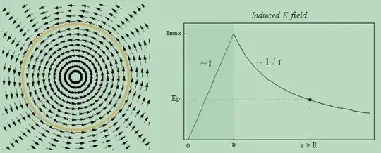

The induced electric field
It can be shown that the induced electric field generated by the spatially uniform time-variable magnetic field of a circular section solenoid (either infinitely long and linear or closed on itself like in a toroidal transformer), or even of an electromagnet driven by a variable current is directed along concentric lines and grows as the distance r from the center of the section when inside the magnetic field region, but decreases as 1/r outside of it. In the following picture the orange ring of radius R denotes the boundary of the uniform variable magnetic field zone. The B field is understood to be spatially uniform and perpendicular to the plane of the ring and the direction of the induced electric field depends on the direction of B but most importantly on the sign of its rate of change.
Induced field of a variable mag field with circular boundary Emax is the maximum value the induced field can reach, and it achieved right at the boundary with the magnetic region. If you use a toroidal transformer powered by a sinusoidal current, and you are at a distance r>R you will see a cosinusoidal varying electric field proportional to Ep cos wt and always directed along circumferences. The electric field arrow getting bigger, then smaller, change direction and getting bigger in the opposite direction
Symmetry plays a dominant role in finding the solution and you can find proofs on most physics and EM books, for example on Ohanian, "Physics" 2e p. 791 for the long solenoid and on Ohanian, "Physics for Engineers and Scientists" 3e p. 1006 for the electromagnet. What is important to us is that (given a circular magnetic region of radius R) at a given time t:
  • \$E_{ind}\$ is proportional to \$r\$ for \$r\leq R\$
  • \$E_{ind}\$ is proportional to \$1/r\$ for \$r \geq R\$
Note that in the process of computing the emf and the field relative to a given path, we are considering only geometrical, mathematical, ethereal paths. There is no matter involved yet: when you put matter inside the induced field, the electrons will react and will re-dispose themselves, disturbing the original field and altering it in what will be the total resultant field. Fortunately we can use superposition to find the final result.

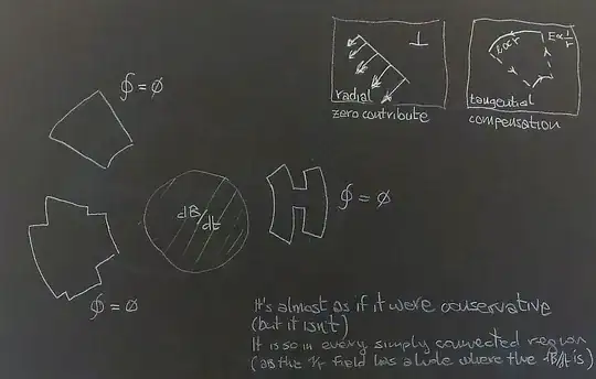

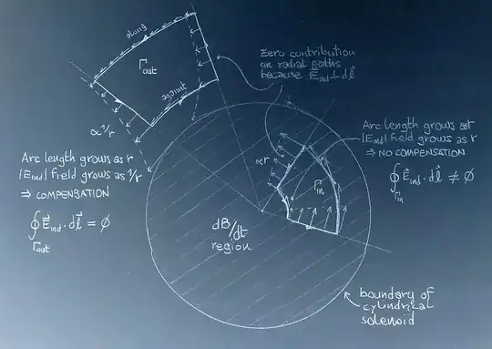

Closed paths and convervativeness
Before putting matter in, let's see what this configuration of induced field means for a special kind of paths (again, mathematical paths) inside and outside the magnetic field region. Look at these two circular (truncated) sectors: they are composed of two radial parts and two circular parts. Now, let's compute the emf along these paths by computing the line integral of the induced field (the only field present here)
induced e field along special paths
The induced field is perpendicular to the radial paths, so it will not contribute anything to it. What about the circular parts? Well, since the field is directed along the circumference, the contribute will be total: \$E_{ind}\$ and dl are parallel so their scalar product will be the product of their magnitudes. Each circular segment will contribute \$E_{ind}(r)\$ times the length of path. Path length for this circular segments will grow as r (note that for the same path they both subtend the same angle).
Now, outside the magnetic field region \$E_{ind}(r)\$ grows as \$1/r\$, while path length grows as \$r\$, so the path integral contribute along these segments will be identical (along one you have strong field along short distance, in the other weak field along longer distance). But their sign will be reversed, because in one case the \$E_{ind}\$ field will go along the path, while in the other it will go against it. The net result is that the path integral along these paths will be zero. No emf is induced in them. And this is to be expected since they do not link and variable magnetic field region. (different story applies to the truncated sector paths inside the magnetic region, but we are not interested in them in this post)
Now, this peculiarity about closed sectorial paths outside the magnetic field region can be generalized to paths of any shape that do not enclose the dB/dt zone: just decompose them into radial and tangential segments to show that it true. It so appears that the induced electric field behaves like a conservative field, after all.
Closed paths in simply connected regions
But, wait! What happens if we avoid including a 'compensating arc' that goes in the opposite direction? We can do that by going around the variable magnetic field region, like this
closed path around the hole
In this case the path DOES link and emf and its always the same emf no matter the shape and the size of the path. In any case this is not what a conservative field would do.
So, by playing with vectors we have come to the conclusion that the induced electric field behaves like a conservative field in every portion of space that DOES NOT include the variable magnetic field region. The region of space where the induced field behaves like a conservative field has a hole in it.
Sneak preview: That 'hole in conservativeness space' is the reason why Lewin's ring is unlumpable: by placing resistors on the opposite sides of it, Lewin created a circuit whose path cannot be shrunk to a point, as you would need in the zero-dimensional approximation of lumped circuit theory. So, there is no way to include the effect of the variable magnetic field in lumped components, like for example using mutual inductances instead of the two pieces of wires connecting the resistors (or four mutual inductances if you want to isolate points A and B midway) because you cannot exclude the variable field region from the circuit's path.

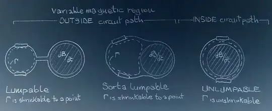

Lumped, lumpable and unlumpable
Geometry matters. Lewin's circuit requires the two resistors to be on the opposite sides of the 'hole in conservativeness' that is the variable magnetic field region. You cannot stretch the circuit path by making the part with the resistors shrink to a point (imagine the resistors are points as well) as required by lumped circuit theory without forfeiting this geometric constraint. This makes Lewins' ring unlumpable.
In lumpable circuits, on the other hand, geometry of the circuit does not matter (it might matter inside the components, but we are supposed not to pry them open to look inside)
Sure, you could put both resistors on one side and pretend the remaining conductor is the secondary coil of a transformer, but that would be a different circuit, a lumpable one with a jump in voltage that Lewin's ring does not exhibit.
Just put a ring on it

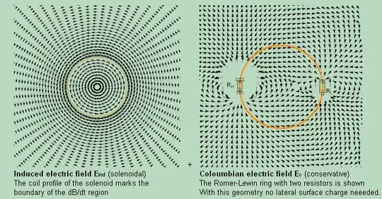

A tale of two fields
If we accept the demonstrably reasonable assumption that the current in the ring is not altering the magnetic field B in a perceptible manner (you can compute the field associated with 1mA at the rate of change implied by the frequency or timing if you wish), we can conclude that the coloumbian electric field \$E_c\$ generated by the charge accumulated at the resistors' end will not alter the induced field \$E_{ind}\$, which retains its independence from what happens in and around the ring. In the Romer-Lewin ring experiment, the total field is thus the superposition of two fields: the independent induced field (meaning that it is caused by the excitation alone and is left unfazed by whatever happens in the ring) and the coloumbian field produced by the charges displaced by said induced field.
\$E_{tot} = E_{ind} + E_c\$
The latter is a conservative, irrotational field that admits a potential function. For this partial component of the total electric field we can define a potential difference that does not depend on paths but only depends on endpoints. This is the 'unique potential difference' some of the "KVL always hold" champion believe is immune from (nonexistent) probing errors. Well, it is not such a thing. It's just half of the story and it's not anything new either: Helmoltz has a theorem by his name that tells us that any (reasonably behaved) vector field can be decomposed in its irrotational and rotational components. They are components and as such the total field is the... composition of the two.
These are the solenoidal and conservative components of the total electric field in and around the Romer-Lewin ring
Note: there are two rings in the experiment. (Left) The ring of the solenoid (or the footprint of the electromagnet) delimits the boundary of the variable magnetic field region. This region is completely contained inside the bigger Romer-Lewin ring with the two resistors (Right). The total field Etot is the composition of the electric field Eind induced by dB/dt and the coloumbian field Ec due to the displaced charge in the ring with the resistors.
They can easily be determined thanks to the extreme symmetry of the setup. The fact that the ring with the resistor is circular and centered around the solenoid will remove the necessity for lateral surface charges to steer the coloumbian field inside the circumference of the ring. The field shown on the right was computed with two pairs of opposing charges in 9:1 ratio to represent the charge at the terminals of the 900 ohms and 100 ohms resistors. Even with such a crude approximation, notice how well the arrows of the \$E_c\$ field follow the circular profile of the orange ring, in a direction opposed to the \$E_{ind}\$ field.
In a perfect conductor, this tangential \$E_c\$ field will completely obliterate the opposing tangential \$E_{ind}\$ field, leaving zero electric field inside the wires. In copper, considering the very high conductivity, there will be a very small resultant electric field \$E_{tot}\$, compatible with Ohm's law: \$E_{tot} = j / \sigma_{copper}\$
In the real world where there is no such symmetry because the solenoid and _the ring are not centered and or the shapes are not perfectly circular, some lateral surface charge will develop on the conductor and resistor (you can read more about this in my answer to "Is the electric field in a wire constant") but this does not change the total field inside the ring which we can represent in this way:

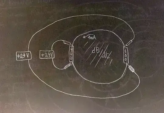

The ring
This, in the end, is what counts: the final configuration of the TOTAL electric field inside the ring. And what we see here is that WITHOUT ANY PROBES we have (at least) two different paths joining points B and A that have different configurations of the total electric field \$E_{tot}\$. If we go from B to A along the bigger resistor RH the path integral that represents voltage will give us the value of 0.9V, more positive in B; if we go from B to A (THE VERY SAME TWO POINTS) along the smaller resistor RL the path integral will give us a voltage of 0.1V, more positive in A.
The voltage across the very two same points can have (at least) two different values at the same time. And it is not a probing error because THERE ARE NO XXXXXXX PROBES! (Sorry, but I really, really really had to vent it. It was not directed at you but to all those engineers who sardonically smiled at Lewin).
Moreover, there is no "distributed emf" along the ring: the induced field has been 'used up' to create the very same distribution of charge that obliterates it almost completely in the conductor. The only trace of emf that remains is in the voltage drop across the resistors. The 'magnetic emf' that comes from Faraday's law is, so to speak, invisible in the ring.

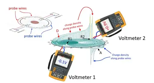

Now, let's add these probes anyway to see how you can still apply Faraday to explain the different values read by the voltmeters on the two sides of the ring. I will draw the ring a bit differently, to stress a couple of points:
Lewin ring with voltmeters
Note that I purposely used a deformed ring and loosely arranged probes. This is because, as long the the variable magnetic field region is completely enclosed inside the ring and the probes do not cut through it [note], it does not matter how big and shaped the ring is. When we analyzed the induced electric field \$E_{ind}\$ configuration, we have seen that the emf linked by any path completely enclosing the dB/dt region is always the same. (In the real world, where the finite conductivity of copper has to be taken into account, a big enough ring will introduce losses that will make the induced current too small to be measured, but this does not concern us). The only difference a wonky ring will introduce is some lateral surface charge on the conductors to steer the coloumbian electric field inside the path. But the total electric field inside the conductor will always be E = j/sigma and directed along the path (zero, in a perfect conductor.)
One more thing: for the same reason as above, the length and the shape of the path of the probes does not matter. It would matter if you were careless enough as to let a significant portion of the magnetic field escape or close in the region where you place the probes; but this is not the case in Lewin's carefully setup experiment (I cannot say the same for the experiments done by other subjects, though)
Finally, note that I have used different positive conventions for the verse of the loop currents. I did it on purpose so that the currents in the voltmeters will be positive when the reading will be positive. The circuit will give the same solution, no matter how I decide to call I2 positive.

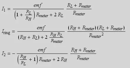

Equations
Solving these and massaging the result a bit we obtain (provided I did not commit mistakes!):
solutions - exact
When we plug in the values (RH = 900 ohm, RL = 100 ohm, Rmeter = 10 Mohm, emf = 1V) we get
I1 = 89.993 nA
Iring = 1,00008 mA
I2 = -10.007 nA
(notice that the current Iring is a bit over 1mA. The reason is that the emf is pushing through a tad less resistance than before because RL and RH are in parallel with the voltmeter's internal resistances. Also I am using 10meg for the internal resistance of the voltmeters, when Lewin used 100meg). The positive value of I1 and the negative value of I2 tell us that the voltmeter on the left will read a positive voltage, while the one on the right will read a negative value. The values of the voltages read by each voltmeter match the voltage drops across the resistors on their side (meaning, the resistor that is part of the loop for which KVL can be applied), as we can see:
V1 = Rmeter * I1 = 899.993 mV
VRH = RH * (Iring - I1) = 899.993 mV
VRL = RL * (Iring + I2) = 100.007 mV
V2 = Rmeter * I2 = -100.007 mV
and these basically match the values computed with the ring alone, with one single pass of Faraday's law. The only error introduced by the probes is a negligible load effect of 7nV.
If you slide the probe tips on the ring to make them touch themselves in the points A and B diametrically opposed, you will see that these equations are telling you that you will read different voltages with voltmeters on the opposite sides of the ring and you should not be looking for (nonexistent) voltage drops in the arcs of the ring or the probes. Something that is immediately clear when you look at the total electric field in the ring.

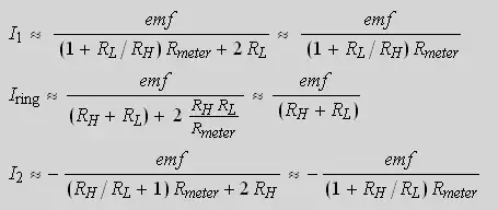

As a bonus, here are two approximations of the exact solution
solutions - approximate
from which it is easy to see that the currents through the voltmeters are in the same ratio (approximation errors apart) as the resistors, hence they are in the same ratio as the voltage across the resistors - as expected.
RH/RL = 900 / 100 = 9
I1/I2 ≈ - 1/(1+0.1)/(1/(1+9) = - 9/1.1 = - 9.091
[note] You can still get the same measurements even if the probes are inside the ring, as long as they stay clear of the variable magnetic field region and do no run around it. And if you really, really have to put the probes inside the magnetic field region, you can still use Faraday to compute the voltages read by the voltmeters - you need to pay attention to the geometry of the problem and compute what fraction of the area of the variable magnetic field region is enclosed in which loop.

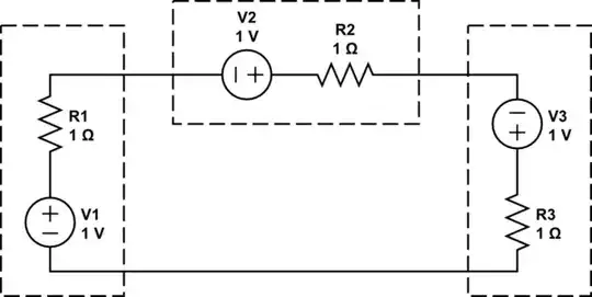

To consider the distinction between electromotive force, and voltage drop, consider the following circuit.
schematic
In this schematic, the resistance and voltage source R1 and V1 are meant to belong to the same physical component. Similarly for R2 and V2, and R3 and V3.
The total emf around the circuit is 3V. By Ohm's law and KVL, the total current in the circuit is 3V/3\$\Omega\$ = 1A.
However the voltage drop across each component will be the 1V voltage source minus a 1V voltage drop across the associated resistor (1A x 1\$\Omega\$) or 0 volts!
Hopefully, at this point, the distinction between emf, and voltage drop should be clear. There is definitely an emf in this circuit, which is causing current to flow, but there is no voltage drop across the terminals of any of the lumped components.

which means that E is a conservative field. Being a conservative field implies that E is the gradient of a potential function, (which is commonly called V, but we will call it U so as not to confuse it with V which we are using to represent a voltage drop.)
$$E = \nabla U$$
U, being a potential function implies that the voltage drop V from a to b is path independent. The voltage drop V from a to b is equal to the potential at b minus the potential at a. We call such a path independent voltage drop a potential difference.
Note that when a circuit is cut by a time-varying magnetic field, the E field is not conservative, and so there is no potential function. However, this does not entail that there is any ambiguity whatsoever in the voltage drop through a particular path segment.

Let us apply this analysis to the example of three resistors affected by a time varying magnetic field given in the question.
If the voltmeter is placed at the location in the diagram, and there is net magnetic flux flowing through the triangle ABC, and negligible magnetic flux flowing through the triangle "V"AC, then there are two closed loops we can consider.
One closed loop just includes the volt-meter, it's leads, and the resistor between A and C. (call it R1). Since there is no emf induced in this loop, the sum of the voltage drops must be 0. So the voltmeter will read the negative of the voltage drop (say from A to B) across the R1, which is just \$R_1I_{R1}\$.
A second closed loop includes the volt-meter, it's leads and the other two resistors. In this case there is an emf induced in the loop. By KVL and Ohms, law, that emf is equal to the negative of the current through each of the resistors times the sum of their resistances. So, the emf is I(R1 + R2 + R3). We now subtract the voltage drops of across R2 and R3, and again we arrive at the conclusion that the voltage drop across the voltmeter will be the negative of the voltage drop across R1 from a to b.
Note that we get the same result regardless of which loop we choose.
Now suppose the voltmeter is on the opposite side of the triangle, but still connected to points A and C. That is, move the voltmeter so that point B is now in the interior of the triangle "V"AC.
Again, there will be two loops to choose from, but both loops will give us that the voltage drop across the volt-meter will be I(R2 + R3).
That is, the voltmeter will display different values depending upon the "side" of the circuit to which it is attached, but what it displays is easily calculated by finding the emf around a loop, of which the voltmeter is a part, and subtracting the voltage drops of the other components in that loop.

  • Right after you wrote the equation for E(r) (in start) , you wrote integral form of the equation, and you moved the time derivative outside integral, but that only works if the bound of integraiton doesn't change w/ time. So, that is not a problem here? – tryst with freedom Mar 06 '21 at 20:44
  • "(but the circuit is still small compared to the wavelength" I don't understand, which wavelength do you refer? – tryst with freedom Mar 06 '21 at 20:45
  • " you may represent the magnetic contribution with a lumped inductance. You have to apply the whole equation:" how did the integral transform to the terms in the next line?, what if the circuit has capacitance? – tryst with freedom Mar 06 '21 at 20:46
  • I'll try reading the paper soon (hopefully within 2 days), been a bit busy today. – tryst with freedom Mar 06 '21 at 20:47
    @Buraian Yes, I have assumed the bound of integration is constant with time. The wavelength is the ratio between speed of light and frequency of your voltage source (see the second paper, page 1). For the equation of the lumped inductance, same paper on page 7 has the proof. If there is a capacitance, you get a term + Q/C in the last equation – Kinka-Byo Mar 06 '21 at 20:58
