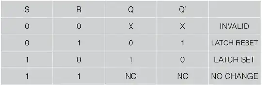

At some video tutorials, people explain the SR flip-flop like this:
SR1
So they use NAND gates, producing a transition table like this:
|     t     | t+1
|  S  |  R  |  Q
|  0  |  0  |  INVALID
|  0  |  1  |  1
|  1  |  0  |  0
|  1  |  1  |  ?

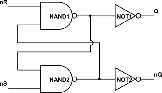

Back to your circuit: take the two little balls, cross the NAND gates (splitting the balls). Now you've got two OR gates and four balls. Remembrer that a ball represents a NOT gate:
schematic
Now as you see R and S are negated as soon as they enter the circuit. We can agree and "simplify" NOT3 with R and call that input nR, and similarly with S and NOT2.
Now let's push NOT4 till the T crossing: what happens there? Well you can negate the AND output, and to keep the downstream value of nQ you should put a not there also.
A diagram is worth a thousand words:
schematic
simulate this circuit
Now you can simplify Q and NOT1 and label that output nQ, and simplify nQ and NOT2 and label that output Q. Does the circuit look more familiar now? Your second circuit is just like the same, only what you call set and reset changes.

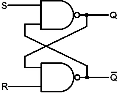

It is possible to construct a simple SR flip flop using NOR or NAND gates. There isn't much difference in the output. The only minor difference occurs because of the properties of a NOR or a NAND gate.
Consider a SR flip flop using NAND gates:-
SR FLIP FLOP USING NAND GATES
The truth table can be given as:-
NOR FLIP FLOP TRUTH TABLE
Now, consider SR flip flop using NOR gates:-
SR FLIP FLOP USING NOR GATE
The truth table can be given as:-Truth table for SR FLIP FlOP using NAND
The circuit will work in a similar way to the NAND gate circuit above, except that the inputs are active HIGH and the invalid condition exists when both its inputs are at logic level “1”. It just depends on the one you prefer to use otherwise both have the same working.
