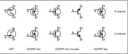

Image that's confusing me
The above image confuses me. For the N-channel, it shows the diode's polarity going towards source in some, but away from the source in others.

As your picture shows, there are both N-channel and P-channel devices, as well as enhancement mode and depletion mode devices. In all of these cases, current can flow from source to drain as well as from drain to source - it's just a matter of how the device is connected in the circuit.
Your picture does not show the intrinsic diode in the devices - the arrow point towards or away from the gate is an indication of the channel type (N-channel points towards the gate, P-channel points away from the gate).

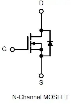

n-channel enhancement MOSFET
This symbol shows you the inherent diode between drain and source.

Conventional current flows from Drain to Source in an N Channel MOSFET.
The arrow shows body diode direction in a MOSFET with a parasitic diode between source and drain via the substrate. This diode is missing in silicon on sapphire.
2a is a JFet so different topology.
2d is a MOSFET with no body diode. I've never seen one.
2e is a depletion mode FET - it is on with no gate voltage and takes negative voltage to turn the FET off. So the diode has the other polarity, otherwise the body diode would conduct whenever there was gate voltage.

    Typically you use 2d (even better, without arrow, as the source/drain is determined by the voltage, and not a priori) in digital circuits. The bulk, in fact, is typically connected to the rail (VCC or GND, depending on the MOSFET polarity).
    But yes, there exists "MOSFETs" without body diode: thin-film-transistors (either organic or inorganic) are an example.
    – next-hack Oct 15 '17 at 07:25
  • @next-hack (2) Yes. Also insulating substrate devices such as Silicon on Saphire. (1) I dislike the arrow-less symbol. Your "... determined by the voltage ..." comment is somewhat ambiguous (not wrong per se - just of uncertain meaning here.) A given physical device is always a P or N channel and the source and the identity of the three terminal does not change. The channel is enhanced in 2 quadrants by Vgs so in eg an N channel current flow may be D to S or S to D BUT Vgs must always be positive to turn the device on. I know you know this but I read your comment as suggesting otherwise. – Russell McMahon Oct 16 '17 at 03:47
    Yes, sorry, I was referring to planar MOSFETs in ICs, where they are symmetric, and they are drawn as a 3 terminal devices, because the substrate is connected to VDD (pMOSFETs) or GND (nMOSFETs). – next-hack Oct 16 '17 at 05:12

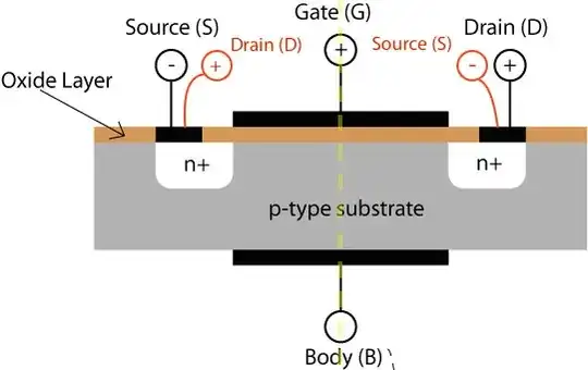

Yes, the current can flow from drain to source and vice-versa. To simplify it even further, I would like to add a bit to just what @Adam Lawrence has mentioned.
I am sure you are familiar with the cross section of the CMOS transistor. You can see that the cross section of the Mosfet is EVEN from the center vertical line. So, whichever (out of the two terminals on sides of nmos) terminal has higher voltage than the other terminal, that becomes your drain (for NMOS) and the other terminal with lower voltage becomes the source (for nmos). The reverse is followed for pmos.
Nevertheless, be careful when buying/dealing with discrete 3 pin Mosfets (i.e SiHG47N60EF) where internal bulk is already connected to the source(for nmos) or to the drain (for pmos) internally. This makes the mosfet pins predefine as mentioned in the datasheet. In that case, the above is still true that higher voltage terminal is drain and lower voltage terminal is source for nmos. However, if you apply higher voltage to the predefined source as mentioned in the datasheet, the threshold voltages will not be same as mentioned in datasheet. And your transistor will not behave as same as what is specified in the datasheet.

    But this switching based on voltage wouldn't work in most actual transistors because they are diodic, right? – PitaJ Sep 16 '15 at 23:11
    Yes they are. Those diodic mosfets are referred to as reverse body diode which have slightly different structure from the one above and you are right, they won't work if you swap drain and source pins. The picture above depicts the mosfet usually referred to in an integrated chip i.e VLSI designs. – dr3patel Sep 16 '15 at 23:51
