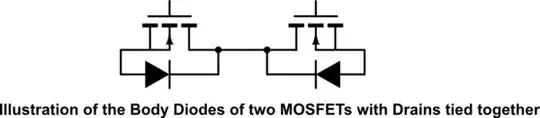

Sometimes you want that, sometimes you don't. When you don't you connect two MOSFETs in reverse, and the total picture becomes this:
schematic
simulate this circuit
When the one body diode conducts, the other blocks and vice-versa.
Now in the case of a battery protection, both MOSFETs are connected with their gate to an independent I/O pin, because when the battery is empty, it is allowed to be charged and when it's full it is allowed to be discharged. So the chip only turns on the MOSFET whose diode blocks the allowed directions, and if the battery is at one extreme of its use-case, its body diode will at least allow current in the other direction, even if the over or under voltage situation persist a while after current starts flowing.
Whether or not this might cause problems with MOSFET heating when a battery behaves super weird is a separate point and has up to now be proven to be not an issue. Usually the body diode only conducts a fraction of a second before the over/under voltage disappears and both MOSFETs turn back on.
The diodes shown in the schematic might have indicated this fact (my eyes glossed over them initially), but it's equally likely they intend for you to place better diodes to support higher safe discharge currents from a full battery or charge currents into an empty one.

In practice, a power MOSFET has a body diode in parallel with the channel. These parasitic diodes are an intrinsic part of a power MOSFET. As a result, a power MOSFET can block current only in one direction. The switch in the battery protection circuit has to block current in both directions: charging and discharging. That's why there are two opposing MOSFETs in series: one for each direction.
