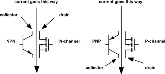

-0.13A is the continuous drain current, Id.
Whenever someone says "something current", they mean the current into that thing. You hear this frequently with transistors: "drain current", "collector current", "base current", and so on.
With N-channel FETs or NPN BJTs, the current usually goes in the drain/collector, so the current is positive.
With P-channel FETs or PNP BJTs, the current usually goes out the drain/collector, so the current is negative.

The BSS84 is a P-channel transistor, in which the current flows from source to drain. So the indicated current carries a minus sign because it is measured relative to a drain-to-source convention.
For more information, see : In an NMOS, does current flow from source to drain or vice-versa? The answers are well detailed.

A P-Channel MOSFET used as a switch is normally connected such that conventional current flow would be from source to drain when it is switched on (not drain to source), due to the fact that the MOSFET's internal diode would always conduct from drain to source.
The Drain Current spec (ID) in MOSFET datasheets is usually given as positive for current flowing from drain to source.
So for P-Channel MOSFETs you'll usually see ID given as a (-) negative value to indicate that the current is flowing in the opposite direction.
If you compare this to the datasheet for an N-Channel MOSFET, you'll see that the ID value there is (+) positive.
