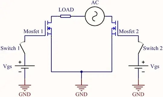

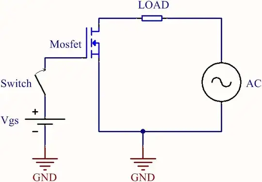

Edit: Your schematic here: enter image description here
Illustrates one example of switching AC with two MOSFETs (one of which will be conducting in reverse at any given time when the switches are on).
