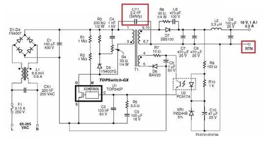

Because modern SMPS wall warts (or equivalent) don't tend to use the ground wire in the socket because many times it's just not available, they have to reliably reduce emissions on the DC output wires by connecting a capacitor from output to rectified line voltage as per this answer: -
Now, the impact of adding the capacitor in the red box is that it can pass a small (safe) amount of AC current through to the secondary and, if the secondary isn't earthed via the laptop or PC then you will feel a (harmless) tingling sensation if you make contact with it.
