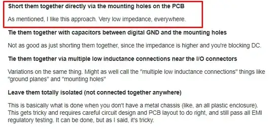

My question is 1. What might be the cause of the generated AC potential? 2. As I have gone through some possible solutions I have found the following LINK; enter image description here
I have connected the circuit ground to a metal and again connected the earthing wire to the metal. What impact will it have on my PCB?
