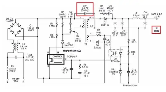

Most laptop chargers don't have an earth connection and to prevent (reduce really) the amount of high frequency switching noise on their DC output they use a Y capacitor connected from the DC output to the nearest thing to earth that can be found; that being the rectified DC bus on the high voltage side. See this for an example: -
The size of the capacitor is usually about 1 or 2 nF and this inevitably can couple a proportion of the AC mains voltage to the DC output. So, which is worse? A noisy DC output full of high-frequency switching artefacts that can radiate or a little bit of AC voltage that is sourced through a 2 nF capacitor and causes you to feel a tingle?
In case you didn't understand the bit about high frequency noise, you just have to look at the culprit - the high-frequency power transformer - it has an inter-capacitance winding of about 100 pF and, the high-speed high-voltage switching on the primary inevitably superimposes some noise on the DC output. It's common-mode noise so it doesn't alter the voltage between the positive and negative DC outputs; it raises both of them up and down by several volts and can interfere with radios and needs quenching, hence the added capacitor (in the red box above).

You could find a good earth point and use capacitors from each DC output to the earth point - 100 nF would kill off the AC to sub 1 volt levels.
