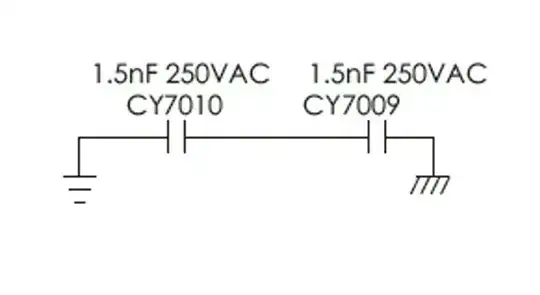

When reading thru the power supply schematic of a sharp brand television, I noticed the link between the low voltage ground and the mains rectified DC ground.
What is the purpose of this? Don't we achieve best galvanic isolation if such link is not there?

That link is two capacitors in series, so there is no DC current path through it. However, it will allow high-frequency signals straight through, which provides a path to ground for noise and EMI in the system.
The use of two capacitors and the Y-rating on the capacitors is there to prevent the isolation failing if one of the capacitors fails.
