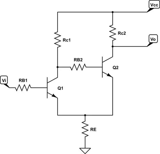

Here is the classic Schmitt trigger:
schematic
And I would like to find the equation for the threshold voltage (\$V_L, V_H\$).

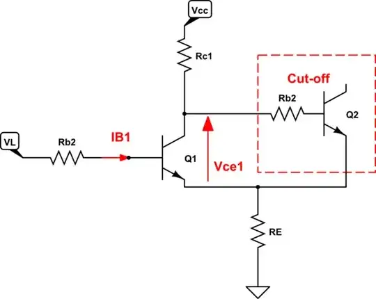

First I examined the case when \$Q_1\$ is starting to come out from the saturation region and \$Q_2\$ starts to turn on (input voltage ramps down from Vcc towards the lower threshold voltage VL).
This situation looks like this:
schematic
simulate this circuit
And this current \$I_{B1}\$ is equal to:
$$I_{B1} = \frac{V_{CC} - V_{CE1}}{(\beta+1)R_E + \beta R_{C1}}$$
And the threshold voltage is:
$$V_L = I_{B1} \cdot R_{B1} + (\beta+1)R_E I_{B1} + V_{BE1} $$
$$V_L = \frac{(R_B1 + (\beta+1)R_E)\cdot (V_{CC}-V_{CE1})}{R_E+ \beta (R_E + R_{C1})} + V_{BE1}$$

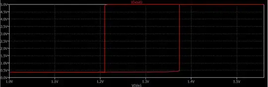

Suppose \$R_{\text{B}_1}=27\:\text{k}\Omega\$, \$R_{\text{B}_2}=100\:\Omega\$, \$R_{\text{C}_1}=1.5\:\text{k}\Omega\$, \$R_{\text{c}_2}=1\:\text{k}\Omega\$, and \$R_\text{E}=47\:\Omega\$. Let's assume \$V_\text{BE}=700\:\text{mV}\$ for both transistors and that both have \$\beta=200\$ when active mode. Assuming that just leaving saturation and entering into active mode occurs at \$V_{\text{CE}_2}=700\:\text{mV}\$, then I get: \$V_\text{H}\approx 1.388\:\text{V}\$ and \$V_\text{L}\approx 1.206\:\text{V}\$.
Let's see what spice shows:
Using .MEAS triggers in LTspice, it reports: \$V_\text{H}\approx 1.374\:\text{V}\$ and \$V_\text{L}\approx 1.209\:\text{V}\$. Hmm. Not bad, just doing this on the fly, so to speak.

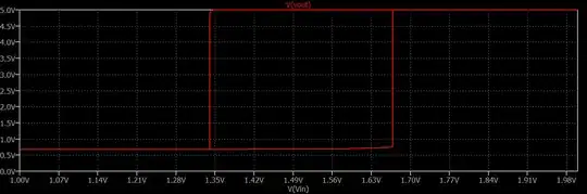

Let set \$R_\text{E}=100\:\Omega\$. From this I get: \$V_\text{H}\approx 1.678\:\text{V}\$ and \$V_\text{L}\approx 1.332\:\text{V}\$.
Using .MEAS triggers in LTspice, it reports: \$V_\text{H}\approx 1.669\:\text{V}\$ and \$V_\text{L}\approx 1.340\:\text{V}\$. Also not bad.

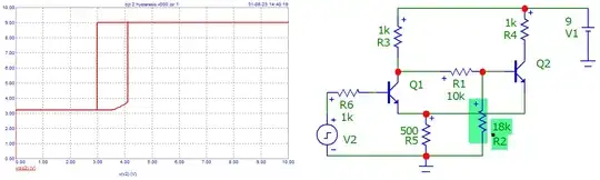

Here is a "visual" of another Schmitt trigger ...
Modified circuit with a new R2.
