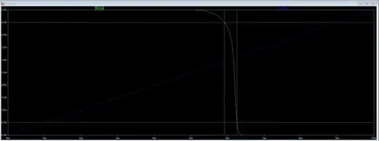

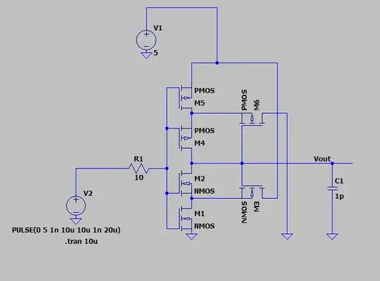

As an example, we can simulate a common CMOS ST circuit in LTspice using the default NMOS/PMOS elements:
I've added two parasitic elements - C1, a 1pF load capacitance and R1 a 10Ω input resistance.
Simulated 1usec rise time at the input leads to 131ns fall time at the output (90% to 10%)
Simulated 10usec rise time at the input leads to 344ns fall time at the output (90% to 10%)
If there was an inverter or two at the output the difference might not be so easy to see due to the increased gain.

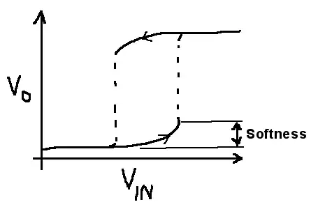

this may not be the case. Suppose the input and output are low; raise the input slowly. As it goes up, Q1 begins to turn on, V(RE) rises, and Q1 collector voltage falls. Vo saturates to V(RE) at the lowest, so, it starts to rise as well. Eventually, insufficient base bias (from Q1-C through RB2) causes Q2 to turn off; Vo jumps up and V(RE) falls a bit (now being supplied only through Q1). V(RE) falling, of course, reinforces Q1's on-ness, hence the hysteresis loop. A similar set of conditions applies for the high-to-low transition.
That is, the transfer function generally looks something like this:
Hysteresis loop
The region where Vo is varying with Vin could be called a "softness" of the curve.
If such a circuit is followed by sufficient gain, so that the sudden switching across the hysteresis loop is amplified into a flat square wave, you have a nice reliable schmitt trigger. Logic chips do this, also to improve output drive strength, and to make the internal state independent of output loading.
As it happens, this circuit does rather well, with the "soft" regions being typically like 5% of the total output swing. Devices with lower gain, like MOSFETs, or the vacuum tubes its inventor Schmitt worked with, will show more "softness".
If you have a trigger circuit so "soft" that the rise/fall time is affected (i.e., encroaching on the 10-90% or 20-80% range that's being used to measure edge time), then input transition rate will affect output edge rate some. The correspondence will be less than proportional, because the hysteresis loop hard subtracts a chunk of the input ramp.
