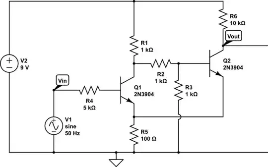

To generate this comparator, I am using a Schmitt Trigger. I set up (experimentally) the resistances in order to give a threshold of 40 cm. Here is the schematic.
schematic
I have found the desired output, but with some problems:
  1. The actual thresholds are not equal to the theoretical thresholds.
  2. When I connect a buzzer in parallel with the output, the voltage falls a lot and it sounds very low. How can i fix this?
And the questions are:
  1. Why are the experimental and theoretical thresholds not equal?
  2. How can I couple a simple buzzer?
  3. Is the biasing correct?
  4. If I want to add an LED, how can I connect it?
PD1: The input wave is there just to give a reference because I can't simulate the sensor.
PD2: The calculations of the thresholds:
  • \$V_{high} = \frac{R3}{R1+R2+R3}V_{CC} - 0.7\text{ V} = 2.3\text{ V}\$
  • \$V_{low} = \frac{R3}{R1 + R2 + R3 + \frac{R1 \cdot R3}{R5}}V_{CC} + 0.7\text{ V} = 2.78\text{ V}\$

  • Ad PD2, I cannot follow your Vhigh and Vlow calculation, do the resistors named the same, where is VCC? Vhigh in your example wouldn't be the voltage at the base of Q2? I would suggest neither the calculated, nor the experimentally ones are right, perhaps the simulated thresholds? Ad 2.) the buzzer would load too much of the very high impedance of output of about 10k. – Tom Kuschel Dec 19 '18 at 22:30
  • The thresholds are extracted from here: https://www.instructables.com/id/Circuito-Schmitt-Trigger-a-Transistores-2N3904/ . Adding a resistor in serie with the buzzer would help to a better coupling with the schmitt trigger?. The simulated thresholds are very similar with the experimentally ones. – Rudy Garcia Dec 19 '18 at 23:15
  • Some discussion of a circuit close to yours is found here. – jonk Dec 20 '18 at 02:40
    I can't tell from the datasheet what the current compliance might be for the analog output. Without knowing that, you'd have to assume "not much" and that might mean a more complex circuit. Also, it's important to know what buzzer you want and its current requirements. We need lots more detail, I think. – jonk Dec 20 '18 at 03:29
  • @RudyGarcia One more question for you to answer. Is that a $9:\text{V}$ battery voltage? Or the voltage from a mains-supplied DC power supply? It's important to know because the battery will have a more widely varying voltage over its lifetime of use and that fact affects some choices. – jonk Dec 20 '18 at 21:21
  • In the final proyect the circuit will use a battery but now i am testing it with a DC power supply. @jonk, the buzzer that i have doesn't have so much information and i couldn't find a datasheet, i tested it with a 6V DC and it works fine – Rudy Garcia Dec 21 '18 at 00:29
  • @RudyGarcia You'll need to make an ammeter measurement of the current in the buzzer when operating, then. The current it requires is important to understand. It affects choices. Same with the datasheet's lack of information about its output -- no current compliance mentioned there. But that's not something you can solve without writing or calling their technical staff. – jonk Dec 21 '18 at 04:33
  • Finally, insert Ad 3: the observed thresholds. – WhatRoughBeast Feb 23 '19 at 17:25

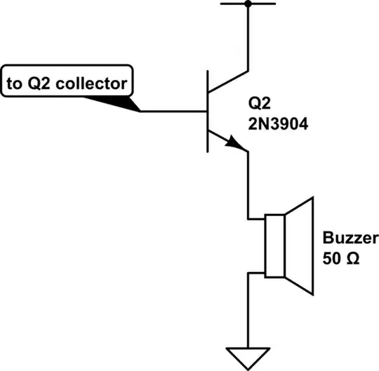

That circuit has a low powered output not suitable to driving medium sized devices like a buzzer.
A NPN transistor can be used common-collector to boost the drive capacity of the output. eg:
schematic
