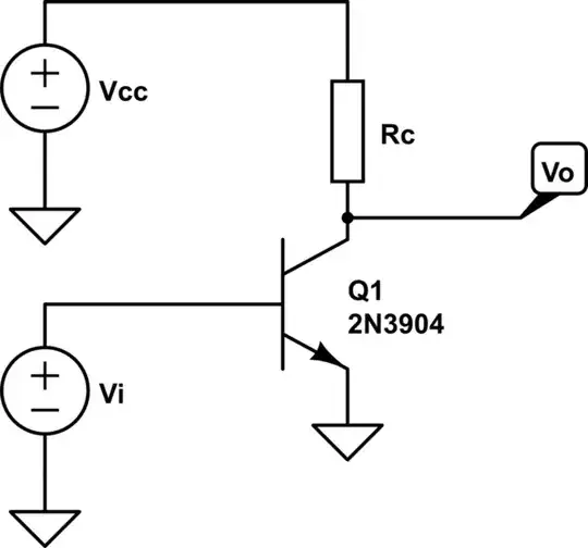

As a self imposed exercise, I tried to derive the complete expression of gain in a common emitter amplifier without emitter degeneration. I mean by "complete" that it also takes into account the distortion associated with it. Here is my notations.
schematic
And my attempt.
Derivation attempt

  • $V_I$ coming out as a constant makes sense, given that that's how ideal diodes behave. In other words, the derivation should make more sense if you put a base resistor in there. – Hearth May 13 '18 at 22:13
  • Since Vbe controls base current , even if β= constant for 5mVp you get a non-linear current. which is why you dont drive Vbe with a voltage source. http://tinyurl.com/y8684ohw – Tony Stewart EE75 May 13 '18 at 22:19
  • I haven't seen yet base resistors except with "transistor switches". Are those still used with emitter degeneration ? – Sachiko.Shinozaki May 13 '18 at 23:09
  • Tony Stewart - while saying "....you don´t drive Vbe with a voltage source..." do you refer to the DC bias or to the signal input voltage? – LvW May 14 '18 at 06:42
  • @TonyStewartSunnyskyguyEE75 I see this as a duty to mention you instead of LvW so we can finaly have an answer after 1.5 years :) You probably mentioned the AC signal source anyway. – muyustan Dec 02 '19 at 19:05
  • In my simulation you can see Av= (3.854-2.539V) / (650-630mV)= ~ 66 = Rc/rBE thus @ 8.3mA rBE= 100/66= 1.6 Ohms What would be your accepted answer? or calculation? – Tony Stewart EE75 Dec 02 '19 at 19:21

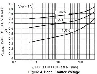

You can get \$I_\text{SAT}\$ from a datasheet. Look at the datasheet for the 2N2222A. Figure 4 follows:
Find the point indicated by \$I_C=1\:\text{mA}\$ and \$T=25\:^\circ\text{C}\$. I read off about \$V_\text{BE}\approx 640\:\text{mV}\$. From this I compute:
$$I_\text{SAT}=\frac{1\:\text{mA}}{e^\frac{640\:\text{mV}}{25.8\:\text{mV}}-1}\approx 1.7\times 10^{-14}\:\text{A}$$
Now, technically, \$V_\text{CE}\$ should be the same as \$V_\text{BE}\$ if I were doing a "one-point" approximation. But this chart is fine for as far as it goes.
Some cautions are worth mentioning.
  1. The chart is typical. Individual BJTs will vary by a factor of 2 or 3. I don't consider that to be much of a problem, though, because of the next point.
  2. You can see what the variation of \$I_\text{SAT}\$ over temperature is like by looking at the chart a little further. There are two other curves, in this case. You can work out just how much \$I_\text{SAT}\$ will vary over that temperature range. Here, you may find it varies from \$I_\text{SAT}=2.3\times 10^{-17}\:\text{A}\$ to \$I_\text{SAT}=8.7\times 10^{-10}\:\text{A}\$.
    This is because the saturation current variation over temperature is about a factor of 2.1 to 2.3 for every \$10\:^\circ\text{C}\$ change in temperature.
    The difference between \$150\:^\circ\text{C}\$ and \$25\:^\circ\text{C}\$ will make a difference between \$2.1^{12.5}\approx 11\times 10^3\$ about about \$2.3^{12.5}\approx 33\times 10^3\$. Roughly, that would predict somewhere between \$1.7\times 10^{-14}\:\text{A}\cdot 11\times 10^3\$ or \$\approx 1.9\times 10^{10}\:\text{A}\$ and \$1.7\times 10^{-14}\:\text{A}\cdot 33\times 10^3\$ or \$\approx 5.6\times 10^{10}\:\text{A}\$ for a temperature of \$150\:^\circ\text{C}\$.
    Which isn't far off from the chart!
    The other curve is \$80\:^\circ\text{C}\$ in the other direction, so here a factor of from about 400 to 800 less, rather than more. So it will be the case that the die temperature will be the real issue. Part variation looks really tiny, by comparison.
    To get nearer to part variations the temperature variations need to stay within about \$15\:^\circ\text{C}\$.
