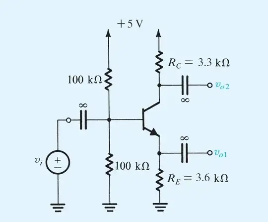

In the following circuit Ic must be found.
I begun by open-circuiting the 3 capacitors, and finding the voltage at the base which is 2.5V (from the voltage divider). By assuming that Vbe=0.7V it's easy to progress, however no such thing is stated (the only data given is that β is very large), so i was wondering if there is a way to find Ic without that assumption.
If we do assume that Vbe=0.7V, then when is the Ic=Is*e(Vbe/Vt) formula used?

  • It might be clearer if you provided the full detail of the exercise rather than feeding snippets. – Andy aka Jun 03 '18 at 18:51
  • I uploaded the full picture. – Manouil Jun 03 '18 at 18:55
    Read this https://electronics.stackexchange.com/questions/337010/why-is-it-possible-to-replace-part-of-a-bjt-circuit-with-thevenin-equivalent/337018#337018 – G36 Jun 03 '18 at 19:01
  • And if you want to include Ic=Is*e(Vbe/Vt) formula. you need to learn first how to solve nonlinear equations. https://en.wikipedia.org/wiki/Diode_modelling#Iterative_solution – G36 Jun 03 '18 at 19:03
  • Also, it is almost to know the exact value for Vbe. Typical we assume Vbe = 0.6V...0.7V in hand calculations. But the error is not big if Vcc>>Vbe – G36 Jun 03 '18 at 19:08
  • @G36 So Vbe isn't 2.5V since the second 100k resistor is in parallel with part of the bjt and the Re (or the load draws some current as they say). About the Vbe part,so is it implied thet Vbe~.7V since the BJT is in active mode? – Manouil Jun 03 '18 at 19:21
  • Yep. Vbe is not equal to 2.5V. Even without Re resistor voltage at the base terminal won't be larger than 0.7V – G36 Jun 03 '18 at 19:43
  • you mean larger than 0.7V + Ve? – Manouil Jun 03 '18 at 19:50
  • Also, for α=1 which means Ib=0 we do in fact have a Voltage divider, dont we? – Manouil Jun 03 '18 at 19:53
    Yes - assuming Ib=0 you can use the simple voltage divider formula. Hence, the voltage at the base node is simply 2.5 volts. As shown in my detailed answer, such a simplification is allowed only because of the negative feedback effect of RE. Such negative feedback always reduces the sensitivity of gain stages against simplifications (in your case: Ib=0 and Vbe=0,7V). Because of these simplifications you do not need the exponential relationship between Ic and Vbe which would require the knowledge of the exact VBE value, – LvW Jun 04 '18 at 06:54
In the enclosed figure (first diagram) it is shown how an emitter resistor RE stabilizes the operating point against uncertainties of VBE. Hence, it is common practice to assume for VBE a suitable value between 0.6 and 0.7 volts because such a relatively large VBE uncertainty results only in small Ic variations (for sufficient RE-feedback).
The dotted line (vertical) shows how RE=0 (no feedback) would result in an unacceptable large Ic variation (uncerainty).

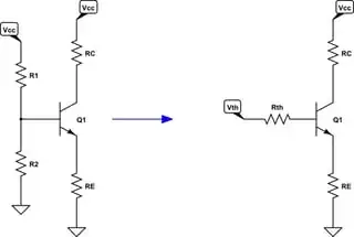

schematic
From KVL, you have:
$$V_\text{TH}-I_\text{B}\:R_\text{TH}-V_\text{BE}-I_\text{E}\:R_\text{E}=0\:\text{V}$$
Where, of course, \$R_\text{TH}=\frac{R_1\:R_2}{R_1+R_2}\$ and \$V_\text{TH}=V_\text{CC}\:\frac{R_2}{R_1+R_2}\$.
From \$I_\text{E}=\left(\beta+1\right)\:I_\text{B}\$, you can substitute in and solve for \$I_\text{B}\$:
$$I_\text{B}=\frac{V_\text{TH}-V_\text{BE}}{R_\text{TH}+\left(\beta+1\right)\:R_\text{E}}$$
Now substitute from your nice formula and solve for \$V_\text{BE}\$:
$$\begin{align*} \frac{I_\text{SAT}}{\beta}\:e^{\frac{V_\text{BE}}{V_T}}&=\frac{V_\text{TH}-V_\text{BE}}{R_\text{TH}+\left(\beta+1\right)\:R_\text{E}}\\\\ \frac{V_\text{TH}-V_\text{BE}}{V_T}\:e^{\frac{-V_\text{BE}}{V_T}}&=\frac{I_\text{SAT}\left[R_\text{TH}+\left(\beta+1\right)\:R_\text{E}\right]}{\beta\:V_T}\\\\ \frac{V_\text{TH}-V_\text{BE}}{V_T}\:e^{\frac{V_\text{TH}-V_\text{BE}}{V_T}}&=\frac{I_\text{SAT}\left[R_\text{TH}+\left(\beta+1\right)\:R_\text{E}\right]}{\beta\:V_T}\:e^\frac{V_\text{TH}}{V_T}\\\\ \frac{V_\text{TH}-V_\text{BE}}{V_T}&=\mathcal{LambertW}\left(\frac{I_\text{SAT}\left[R_\text{TH}+\left(\beta+1\right)\:R_\text{E}\right]}{\beta\:V_T}\:e^\frac{V_\text{TH}}{V_T}\right)\\\\ V_\text{BE}&=V_\text{TH}-V_T\:\mathcal{LambertW}\left(\frac{I_\text{SAT}\left[R_\text{TH}+\left(\beta+1\right)\:R_\text{E}\right]}{\beta\:V_T}\:e^\frac{V_\text{TH}}{V_T}\right) \end{align*}$$
Note that no assumptions were made about \$V_\text{BE}\$ above. None are needed. Just as you thought might be the case! (Also note when \$u\:e^u=z\$ then \$u=\mathcal{LambertW}\left[z\right]\$. See Lambert W Function.)
