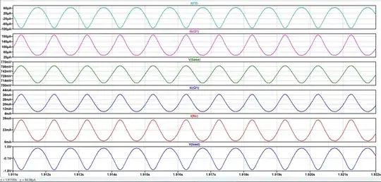

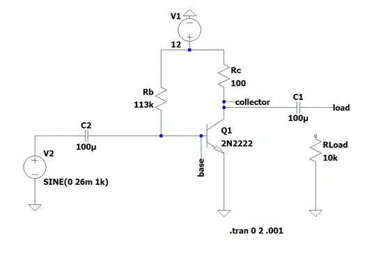

I am trying to learn some transistor amplification by simulating. However there is something I don't understand why.
Why all waveforms are somehow distorted or bad-looking sinusoidal-ish waves instead of nice sine waves? Only the Vbase waveform looks decent.

  • While the answers pointing to the inherent nonlinearity of the device are correct (irregardless of how one might consider the BJT to be voltage or current driven), the reason you are getting that massive distortion is that you are biasing the transistor in a less than optimal way. Try to put the quiescent point in the middle of the output characteristics and things will go better. For example, if you change Rb=160k and Rc= 360 ohm, you will see much less distortion. – Sredni Vashtar Dec 03 '19 at 07:04
A very short answer: The input signal at the base (Vin=VBE) is transferred into an output current Ic acording to the transfer characteristic (control function):
Ic=Io[exp(VBE/Vt)-1]
This is not a linear function and, therefore, the output current does not swing in exact proportion to the input voltage (and the same applies to the output voltage at the collector which is caused by the output current swing). And this nonlinearity causes distortions.
Only for very small input voltages we could consider the relation as "quasi-linear".

    Yes - that is true! In reality, exact linear amplification is not possible. However, we can do a lot in order to improve the situation - and the keyword is "negative feedback". One method is to introduce a "feedback resistor RE" between the emitter node and ground. So we can reduce non-linear effects down to a level where it can be acceptable in many cases. – LvW Dec 02 '19 at 18:48
  • what happens when you use a bypass capacitor across RE ? Does it still provide a reduction in non-linear effects. Because as I know, if not bypassed, RE lowers the voltage gain of a CE amplifier. – muyustan Dec 02 '19 at 19:16
    Yes - that is the price we have to pay for improving the signal quality (less distortions): Lower gain. A capacitor in parallel to RE increases the gain again - however, also the distortions (but DC feedback ist still present and stabilizes the DC bias point.) Therefore, often a trade-off is envisaged: Only a part of the emitter resistor is shunted with a capacitor. So we have good DC feedback and a certain amount of signal feedback. – LvW Dec 02 '19 at 21:08
The base emitter region behaves like a forward biased diode (high in non linearities) hence, as you change the base to emitter AC voltage sinusoidally, the AC collector current that results is non linear. This means that the output voltage is also non linear.
It’s a poor amplifier in the real world.

  • Hmm, is that non-linearity you mentioned related to his ? http://www.zen22142.zen.co.uk/Design/graph/inputchar.gif – muyustan Dec 02 '19 at 18:17
    Yes it is, certainly. If you apply much smaller AC signal levels it improves. – Andy aka Dec 02 '19 at 18:18
