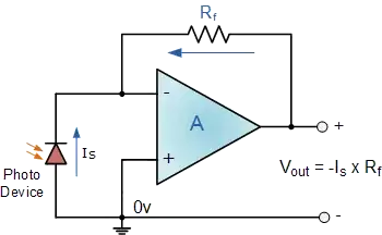

in an answer, and it pops up a lot on Google images too. But does it work? If it does a theoretical explanation will be welcome.

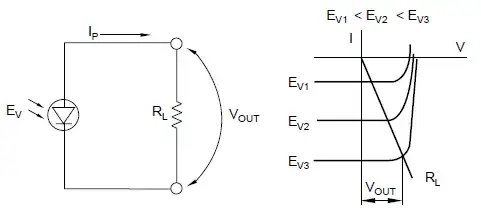

According to this, the photodiode does indeed produce a current even when there is zero volts across it; it's the short circuit current. Note that the reference direction of \$I_S\$ in the question's diagram is opposite that of the \$I_{SC}\$ of the diode so the output voltage is:
\$V_{OUT} = - I_S \cdot R_F = I_{SC} \cdot R_F\$
I found the above here.
A reasonable question to ask is how can a current be produced with zero voltage?
Remember that there's an internal E field through the depletion region even when the diode terminals are shorted together. Briefly, light generated EHPs in the vicinity of the depletion region are separated by the E field resulting in charge accumulating in the P and N sides (that's how \$V_{OC}\$ is developed). A short circuit allows a current to restore charge balance.

  • +1 - it would explain a lot. I still want to keep some of my scepsis, though: a current and no voltage, wasn't that reserved for superconductors? BTW, could you give a link to the document where you found that? – stevenvh Jul 19 '12 at 12:06
  • @stevenvh, Thanks, and I added a link in my answer. Remember that there's an internal E field through the depletion region even when the diode terminals are shorted together. Briefly, light generated EHPs in the vicinity of the depletion region are separated by the E field resulting in charge accumulating in the P and N sides (that's how $V_{OC}$ is developed). A short circuit allows a current to restore charge balance. – Alfred Centauri Jul 19 '12 at 12:29

The classic inverting amplifier is like this:
circuit
The photodiode will create a current, which will cause a voltage drop across the resistor. An opamp with negative feedback will try to make both inputs equal, so the inverting input will be at 0 V, and the current through the resistor will create a positive output voltage.
Why did I think the other circuit wouldn't work? If the diode creates a current you would suppose there's a voltage drop as well. Then the voltage at the inverting input would be higher than zero, and the opamp, trying to correct that, would see its output go all the way down to the negative rail.
Alfred's graph shows however that the input can be driven down to 0 V by the output. It requires that the voltage across the diode can go down to zero, while there's still current. Here's another graph, from this document, which confirms Alfred's answer:

  • An LED in reverse + light creates a negative current from cathode to anode, so the opamp produces a positive current = voltage across the resistor to compensate. – Oli Glaser Jul 19 '12 at 08:50
  • @Oli - yes, that's what I'm saying in the answer too. But does it also apply to the circuit in the question. The output will go down if the inverting input > the non-inverting input. – stevenvh Jul 19 '12 at 08:53
  • I see - yes, it should down if the LED is the other way round so you need a dual rail. I just confirmed this with my setup. – Oli Glaser Jul 19 '12 at 09:07
  • I'll have to give this a -1, since the circuit clearly works. The opamp is interested in equalising the current generated by the diode. It only needs to set it's output to whatever is needed to do this through Rf. – Oli Glaser Jul 19 '12 at 09:15
  • @Oli - I find it hard to believe it actually works. Like in x uA gives you y mV out, and 2x uA will give you 2y mV out. It would need a better explanation than my description of the working of an inverting amplifier. – stevenvh Jul 19 '12 at 09:18
  • It's just a transimpedance amplifier - the LED looks like a current source to the input. Try it out on a breadboard and you should see the same results as I have here (hopefully ;-)) Let me know if you do. – Oli Glaser Jul 19 '12 at 09:21
  • @stevenvh: (I'm not the downvoter, but) you are wrong if you think a photodiode needs an external voltage to create a current across it. – Curd Jul 19 '12 at 10:54
  • The original circuit should work if the opamp is powered so that ground is in its valid common mode input range. The difference is that the original circuit is assuming a photocell, which does produce current with 0 V accross it. Your circuit is using the diode in leakage mode, which requires a voltage accross it. Leakage mode generally gives better light level readings, but photovoltaic mode does work. – Olin Lathrop Jul 19 '12 at 11:40
  • @Steven - Ahhh, I see what you are asking for now, sorry - the voltage across the diode. Alfred Centauri has just posted a good graph of operation, it's like the Isc of a PV cell (as Olin mentions above) – Oli Glaser Jul 19 '12 at 12:00
  • @Steven - well worked question and answer - the way this site should work. Downvote removed. – Oli Glaser Jul 19 '12 at 13:05

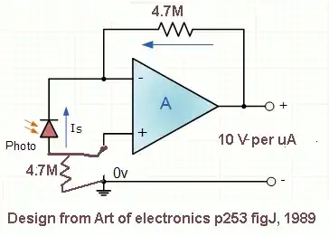

I got the circuit idea below from p253 circuit J, "Art of Electronics", 1989 version. Sharp application note also uses a resistor on the +Vin for an op amp and phototransistor, but does not explain what it does.
I tested the circuit below with and without the bottom resistor: I could see no effect when I pulled out the short over the bottom resistor: not even a change in gain. I am testing at very low light level pulses, using regular 850 nm and 830 nm diodes as "photodiodes". I got much better detection when the "photodiode" was reversed from the diagrams on this page. This is probably important only in low light levels (less than 1 mW/cm^2). When the diode was oriented as shown on this page, the output was not inverted, in contradtiction to everyone's comments. Maybe photodiode manufacturers declare the orientation reversed from what it actually is. A 0.0001 to 0.0047 uF capacitor over the feedback resistor helped reduce spikes on pulses, but made the spikes worse for very low light levels.
Using a back-biased 880 nm phototransistor with the op amp (fig 13 on the sharp application note) with a 830 nm diode supplying the light worked about 10 times better at low light levels than plain 830 nm LED as a detector if pulses were more than about 1 ms, and if a capacitor over the feeback resistor was used. It seems like 0.01 mW/cm^2 detection is possible.

  • What design? A schematic showing what you're talking about would make your point more clear. – The Photon Aug 15 '12 at 18:01
  • This design. Just insert 1 resistor where I indicated. Here's the sharp application note, figure 13. http://physlab.lums.edu.pk/images/1/10/Photodiode_circuit.pdf – scott roberts Aug 15 '12 at 18:19
  • Answers here are expected to be complete in themselves. There's no fixed ordering of the different answers, so if you refer to another answer as "above", or "below" or "this", most readers won't know what you're talking about. Also, when you have the rep, the schematic should be edited in to your answer.
  • I don't see any connection between +Vin and a diode in the figure you refer to, so it's still not obvious what you're talking about.
  • If you make a schematic showing what you mean and upload to Imgur or similar service, we can edit your answer to put the image inline.
    – The Photon Aug 15 '12 at 18:53
  • OK, schematic added to my original post. – scott roberts Aug 15 '12 at 21:07
  • Much easier to understand what you're suggesting now. But there's still 0 bias across the photodiode (which is what OP was asking about). And what is the advantage compared to just having 9.4 MOhm in the feedback path? – The Photon Aug 15 '12 at 21:26
