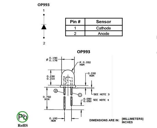

Your PD datasheet should indicate which lead is which (eg. from this datasheet:
You can see that the longer lead is the anode (pin 2), so you would connect the longer lead to ground. Most (perhaps not all) are probably similar to this. It won't hurt anything in this circuit if you get it wrong so if you for some reason don't have a datasheet, just try it. You can also test the PD with the diode test function on your multimeter.

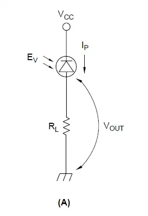

No, your photodiode is not reverse biased in the circuit shown. In fact, both the cathode and anode are at ground, so there is zero bias.
In the figure above, from a superb application note from Sharp (which I can no longer find at Sharp, but it is available at http://educypedia.karadimov.info/library/Sharp%20photodevices.pdf) the diode is reverse biased. The Cathode is at a higher potential than the Anode. This is what's meant by reverse biased. The advantage of reverse biasind a photodiode is higher speed and dynamic range, the disadvantage is higher dark current.
In the feedback circuit you show, the voltage drop across the diode is zero, thus you are moving up and down the V=0 line in the figure above (from the same document) as light intensity changes. Note that photocurrent is a leakage current, from Cathode to Anode, always. The output of your circuit will be the product of the photocurrent and the feedback resistor.
The "bias" of a photodiode refers to the voltage across it, not the direction of current through it (though the two are certainly related).
I suppose you can most accurately call your circuit "photovoltaic", but that's still a transconductance amp. If you attach the anode to a negative voltage instead of ground, it's now reverse biased, and will be faster. Instead of moving up and down the V=0 line, you'll be operating about some negative voltage, but there won't be much difference in the output behavior (aside from a larger dark current and faster response). Also, if it weren't in a feedback controlled mode, you'd have a wider linear output range for a given load resistance, as shown in the figure below (same doc)
