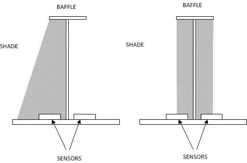

A simple way to do this is with differential measurement:
R1 and R2 are two LDRs (light dependent resistors). A light baffle causes the light on them to be equal when the unit is pointed at the sun. When off to one side, one LDR gets more light and the other less. The voltage between them is then a measure of centerdness, with the middle value being centered. The A/D in the microcontroller reads this value and drives the motors appropriately.
You need one pair of LDRs for each axis.
For extra credit, figure out how to do this with just 3 LDRs. This is possible if you can drive nodes high, low, or measure their voltage only the fly. Fortunately, that is easy to do with a microcontroller.
Added about LDR variations
It was pointed out in a comment that two LDRs will not have exactly the same resistance at the same light level. This means that the voltage won't be exactly the center value when the unit is pointed directly at the sun, which should make the resistances equal.
This doesn't matter much to most applications because:
  1. The light baffle system is set up so that the maximum change in brightness on a LDR as a function of angle is when pointed directly at the sun. Imagine each LDR half in shadow and half in sunlight, for example. Only a small angular change will shift this to all shadow or all sunlight. Even a few 10s of percent mismatch in the resistance will be swamped by only a small angular change from directly aligned. At any other angle, you don't care. You just need to know which side of correctly aimed the system is.
  2. The unit can be calibrated to the voltage actually measured when directly pointed at the sun. This becomes the center reference for the algorithm.
    If the two sensors have different non-linearities, not just overall scale, then the center value is a function of brightness. In that case, calibrate at full sun, since that's when you care most. Put another way, it's not so important to point directly at the sun when it's behind clouds anyway.
  3. If the purpose is to keep something like a solar panel pointed at the sun, note that small deviations from exactly aligned cause very little change in the power hitting the panel. The power due to misalignment falls off with the cosine of the error angle. That is basically 1 for reasonable error angles anyway.
    For example, it takes a 8° aiming error to drop just 1% in power hitting a flat surface. 5° error results in only 0.4% drop.

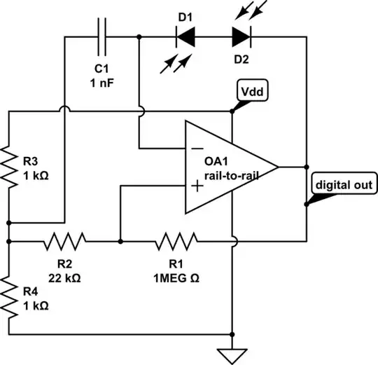

Some decent answers, but many not addressing the desire to determine the balance-point by determining the difference between two photosensors by calculation.
The raw difference circuit is easy, but has serious problems on an overcast day, where op-amp voltage offsets seriously influence the balance-point. One is never sure if bright sunlight is equally exciting two photo diodes, or if a dull sky is weakly exciting the two photodiodes.
So how to use two photo diodes (in one circuit) to determine both light magnitude and illumination difference? Have simulated the following circuit, but haven't built it, so component values likely have to be changed to suit photodiode characteristics. Pulse output has characteristics easily measured by a logic input of a microcontroller. The pulse "high" period is influenced by one photodiode, while the pulse "low" period is influenced by the other photodiode. When both are illuminated equally, pulse high period equals pulse low period. Strong sunlight will give shorter pulse periods, and weak light gives longer pulse periods, so pulse frequency gives an indication of sun strength. A microcontroller with internal clock-counter easily finds frequency and individual pulse-high period and pulse-low period.
Use a rail-to-rail op amp having very low bias current. Many CMOS op amps are appropriate. A digital comparator could be used as well, if it has a logic-type output that actively pulls "high" as well as "low":
schematic
glen_geek
  • 25,809
  • 23
  • 53
  • +1 Thanks @glen_geek. This looks very interesting although I couldn't really see through the logic. But what concerns me here is that the output is digital. That, I suppose, tells me towards which direction is the Sun (which photodiode is in sunlight of the two). But also I will need an indication for this third state that 'lux on both the diodes is very close' so that I can rest my motors in that region. Using this circuit I may reach a dynamic equilibrium on position but this is not what I want as it will consume lot of power and vibrate unnecessarily. – samwise_the_wise Mar 24 '17 at 17:48
    @samwise_the_wise Microcontroller's counter can determine time period of pulse(high) as well as pulse(low). So this circuit plus microcontroller counter is an analog-to-digital converter. Equal counter values tells you that it is balanced, by subtraction. Sum of pulse(high) + pulse(low) tells how bright - a small sum says sun is bright. – glen_geek Mar 24 '17 at 18:02

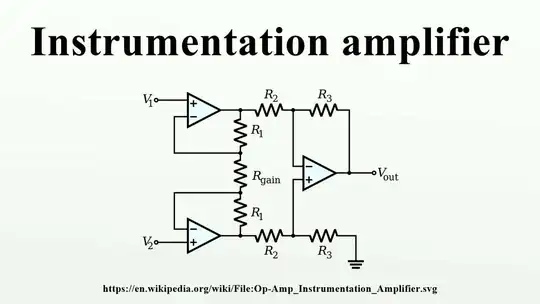

If neither are important to you then you can develop a voltage across a resistor in series with the photodiode and use a difference amplifier for calculating the erm.. difference!
A decent idea is to use an instrumentation op-amp: -
So, my advice is look for an InAmp with rail to rail capabilities (if running from a single voltage supply) or pretty much any old InAmp if you have dual supplies.

  • +1 Thanks a lot @Andy. I should have thought of INA. Thanks for reminding. However, I have this concern everytime I want to use amplifier ICs that if my input voltage is always positive will the amplifier work if I ground the -Vss pin instead of a -5/-12 as otherwise I will then need to have another voltage source only for this purpose. – samwise_the_wise Mar 24 '17 at 14:09
  • You can get InAmps with single rail power supplies but you need to look for one that has rail-to-rail input and output capability (at least to the negative (ground) pin. – Andy aka Mar 24 '17 at 16:21

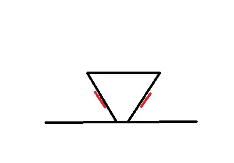

enter image description hereIn addition to Whiskeyjack answer:
You can use 4 LDRs mounted on a reversed pyramid, then you detect pairs of LDR, which is more shadowed. It is easier to detect low brightness rather than high brightness of the Sun. In such way your gimbal moves until the LDRs are in equal shaded position. I guess, the best is to use a differential op amp to compute the brightness/shadowness difference.

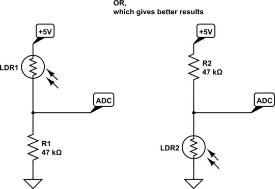

schematic
EDIT: Similar solution as Olin
schematic
simulate this circuit

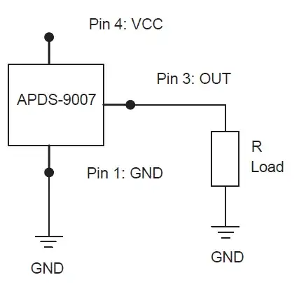

You could use two LDRs, but a better approach may be to use a pair of more active components that are temperature regulated and less sensitive to aging such as the AV02-0512EN. Digikey 516-1719-1-ND ~$1.50
NOTE: This is a 3.3V Device. 100uA when on, but added benefit is it has a shutdown pin that drops that to 1uA. Since I assume you will only adjust the position every minute or more, this seems ideal.
The device is also logarithmic which helps even out the low light sensitivity / high light swamping issues.
R-load would likely be 15K in a 3.3V+ application. You may wish to add a variable resistor on one side so you can calibrate the unit.
Feed each of them to their own ADC pin on the Adrino.
Again, as others have mentioned, you need to arrange them such that there is some form of baffle where they both receive the same amount of light ONLY when the board is pointing "directly" at the sun. The exact geometry of this will dictate how close to the correct angle you can achieve. Having the baffle half "cover" both sensors when it is in-line produces the best directional accuracy.
You may also need to consider some form of lenses or conical light catchers in front of your sensors to give you more of a shaded/lit area to work with. If you do, then you may also need an infra-red filter so the magnifying effect does not cook your sensor.
BTW: Don't discount the temperature compensation feature. A sensor in the sun will have a considerably warmer temperature than one in the shade. That can cause you to slew too far, till the temperature difference inverts, then you drive back... If you are not careful, you end up perpetually "hunting".

  • +1 Thanks a lot @Trevor. This seems to be the best solution for me. But the availability of the module in my location is a problem. Also, I really liked your idea of keeping them half covered for the optimal condition rather than full uncovered which I was thinking. Thanks again. – samwise_the_wise Mar 24 '17 at 14:02
  • They are available from digikey https://www.digikey.ca/product-detail/en/broadcom-limited/APDS-9007-020/516-1719-1-ND/1785439 but whether they can export to your country is another thing. – Trevor_G Mar 24 '17 at 14:06
  • @samwise_the_wise. also, be aware many if not most photo-diodes/transistors have a daylight filter characteristic that will work against you. The above sensor is designed for ambient light. – Trevor_G Mar 24 '17 at 14:15
  • @samwise_the_wise, you may also need to consider some form of lenses or conical light catchers in front of your sensors to give you more of a shaded/lit area to work with. – Trevor_G Mar 24 '17 at 14:19
  • @samwise_the_wise, and don't discount the temperature compensation feature. The sensor in the sun will have a considerably warmer temperature than the one in the shade. That can cause you to slew too far, till the temperature difference inverts, then you drive back... If you are not careful, you end up perpetually "hunting". – Trevor_G Mar 24 '17 at 14:25

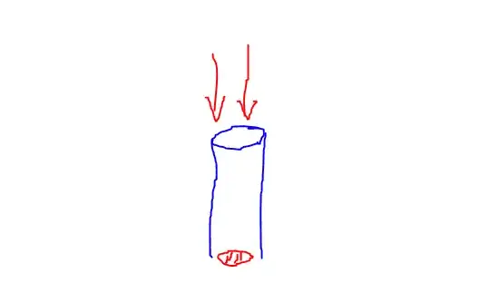

LDRs should work for your use case. However keeping LDR exposed to sunlight won't give you a considerable difference when sun moves. You can make an arrangement like this:
LDR with cylindrical cover
this gives a small access angle through which sunlight can reach the LDR. Use the LDR in a voltage divider configuration to figure out whether this LDR is in line with sun or not. If you increase the length of cylinder or decrease it's diameter, the access angle will reduce even further. Choose a shape which works.

  • Thanks @Whiskeyjack. Will take this into consideration. However, my question is about the schematic. And if you are trying to attempt it please consider my edit to the question about usage of LDRs and photodiodes. – samwise_the_wise Mar 24 '17 at 13:43
