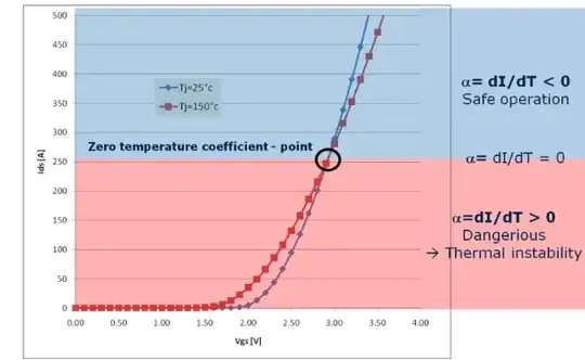

I do not know the answer to your question about physic behind this.
But your statement about MOSFET temperature coefficient is only true when MOSFET work as a switch.
In linear region (saturation) most MOSFET will have as a negative temperature coefficient as BJT have.
And in general terms, the MOSFET can have negative, positive and zero temperature coefficient. And we can see this on Transfer characteristic Id=f(Vgs) in the datasheet.
More here
https://www.infineon.com/dgdl/Infineon-ApplicationNote_Linear_Mode_Operation_Safe_Operation_Diagram_MOSFETs-AN-v01_00-EN.pdf?fileId=db3a30433e30e4bf013e3646e9381200
https://www.onsemi.com/pub/Collateral/AND8199-D.PDF
And here I found a specially designed MOSFET for audio amplifiers application.
http://www.exicon.info/PDFs/ecw20n20-z.pdf
As you can see for this lateral MOSFET if you set the quiescent current at Id > 0.2A you are in the safe zone (zero or positive temperature coefficient) And no temperature compensation network is needed.

  • Okay so for this amplifier it is not applicable, as I've seen they put small resistors at the source, probably for the same reason they do this with BJT, as I mentioned above? Or is this for another reason? As said before, I didn't know the MOSFET had a varying temp coefficient, this schematic is pointed out in my slides when we discuss the facts about temperature coefficient. But Thank you for pointing out that it is a linear amplifier. – J. Joly Dec 28 '18 at 12:49
  • The schematic you have given will do not work. So do not even try to analyze it. – G36 Dec 28 '18 at 13:34
  • As for the IRP250 we can see http://www.vishay.com/docs/91212/91212.pdf (fig.3) that we have the negative temperature coefficient for current in the range from 0A to 12A. So, definitely, you will need a "big" resistance in the source. And a temperature compensation circuit to prevent thermal runaway to occur (vbe multiplier will do the job). – G36 Dec 28 '18 at 13:41
