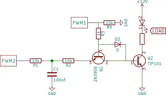

I plan to use two PWMs to very slowly (exponentially) turn on an LED strip, from 0.002% to 0.004%... to 100% power over twenty minutes. 0.002% seems to be a safe brightness that doesn't seem jarring when suddenly turned on, but I can't push much higher than that. The formula I chose (for its very slow start) is: power=(2^(t*15)-1) / 2^15 where t is the normalized time, from 0 to 1. I don't care about the number of steps, so long as none is perceptually large. (So 97%→100% is fine because it's unnoticeable, but 0.002%→0.5% would be quite jarring.) 255 steps would be a great plenty if I could take a step every few seconds, but if the steps represent linear brightness increments, I need more like 51000 steps.
Both PWMs are 8-bits. The high power part PWM1 will take over when the low power part PWM2 reaches a certain level. In fact, the "low power" part of the circuit could drive the light from 0 to 100%, but that half of the circuit (left) is analog, and I can't easily model the brightness. Hence, at the level where I no longer need extremely small gradations, I'll switch over to driving the light with PWM1, which is mathematically nice but incapable of the extremely low power needed for the early steps.
Is this a reasonable circuit to drive a transistor Q2 with both a PWM signal (PWM1) and an analog voltage (after a low-pass filter from PWM2), but not at the same time?
circuit to add digital from PWM1 with analog from PWM2
Note: I will probably not be combining PWM1 and PWM2 dynamically in a "most significant digit / least significant digit" configuration, because the voltage->brightness response from PWM2 is way too nonlinear.
Potential problem:
The low-pass filter may not respond fast enough, so when PWM1 starts sending its signal and PWM2 turns off, the low pass filter may not step down fast enough to avoid a flash. (The flash would occur if the low-pass filter remains on during the early OFF portions of PWM1's signal.) This would manifest in a brief doubling in brightness.
Potential solution: maybe with a diode, capacitor, and a couple resistors, I can hold the base voltage of Q1 high when PWM1 becomes active, even during the off-portion the signal.

    Do you really need that resolution? – Harry Svensson Feb 24 '18 at 13:55
    @HarrySvensson At the lowest levels, I absolutely do, and more resolution would be even better. At the brighter levels, resolution becomes almost unimportant. If you try sleeping when a bright light suddenly turns on at 1/255 power, you'll find how serious this is. – piojo Feb 24 '18 at 13:56
  • I have run into similar problems with PWMing LEDs, and I think you'd be better off finding a PWM source that is capable of 16 bit resolution. – Dampmaskin Feb 24 '18 at 14:45
  • THe problem is you want a logarithmic ramp not a linear ...to exponential. Resolution required depends on how many dB step and smallest step size. – Tony Stewart EE75 Feb 24 '18 at 14:45
    Look into linear-voltage-to-exponential-current converter circuits. They're common in audio synthesis applications, but might apply well here. – Russell Borogove Feb 24 '18 at 15:25
  • Simple anti-log will work – Tony Stewart EE75 Feb 24 '18 at 15:28
  • @TonyStewart.EEsince'75 Thanks, I didn't know anti-log amplifiers were a thing! Still, I'd appreciate it if someone could tell me whether the circuit I posted looks right. – piojo Feb 24 '18 at 16:31
  • Yes u-law and A-law telephony codecs are log to get > 80dB range from 8 bits. So I suggest using 1N4148 diodes and current mirror from Op Amp to convert linear V input into anti-log I output. look around rather than what you have. – Tony Stewart EE75 Feb 24 '18 at 17:50

  • @TonyStewart.EEsince'75 I thought you were saying I should anti-log amplify the voltage, then use a resistor to convert to current, and a current mirror to supply the necessary current to the LED. But that wouldn't use the diodes you mentioned (and would waste 14 watts). Can you clarify? – piojo Feb 25 '18 at 11:07
  • What LED voltage,current do you need? Also what is Vcc and Vin(max)? Then I will show a suitable driver with transistor(s) and OpAmp. Anti-log driver with log eye response gives a linear brightness when more than 2 decades are needed. In monitors they use gamma control for 0 to 100. – Tony Stewart EE75 Feb 25 '18 at 15:27
  • I was thinking of something like this. http://tinyurl.com/yberceoh many alternatives depending on specs. – Tony Stewart EE75 Feb 25 '18 at 16:02
  • That's using a BAT54 diode but gain ratios need to be defined – Tony Stewart EE75 Feb 25 '18 at 16:21
  • @TonyStewart.EEsince'75 Thanks a lot for the circuit! It needs 12V for the LED, drawing 1.15 A at full power. The signal source is Arduino, so whether it's PWM or low pass filtered, the range is 0-5 V. Is that circuit supposed to come after the low pass filter? Because if the signal source is PWM, I don't see any opportunity for variation in output except on and off. – piojo Feb 25 '18 at 16:32

  • also the Darlington will drop voltage too much, so use 14V or a 100mOhm FET – Tony Stewart EE75 Feb 25 '18 at 17:18
  • @TonyStewart.EEsince'75 I thought part of the plan was to have a current-controlled output, so the load's impedance wouldn't matter. As for the Darlington, my version-1 circuit uses a TIP101, and I don't mind the small drop in brightness. (I'm not sure it's a bad thing, since Vcc is 12.3 V with no load.) But thanks for all your help! I need to read a lot more about more op amp circuits before I'll be able to respond intelligently to what you've said so far. I'm very new to op amps :) – piojo Feb 25 '18 at 17:26
  • Ledstrips are usually designed for White from 9 to 14.2V from dim to automotive peak voltage so dropping 12 to 10 is significant – Tony Stewart EE75 Feb 25 '18 at 17:28
  • @TonyStewart.EEsince'75 I would have sworn I measured the transistor to not drop very much, but it's too late for me to either measure it again or read the data sheet. Thanks for all the help. You've given me a lot to think about and read about! – piojo Feb 25 '18 at 17:42
  • The Rce is about 1 Ohm so drop depends on current. Make a list of all known specs in question. For inputs and outputs, including perception and number of steps for smooth transitions at low levels PWM resolution and f. etc etc. Voltage range and current on stripleds 9 to 14V – Tony Stewart EE75 Feb 25 '18 at 17:57

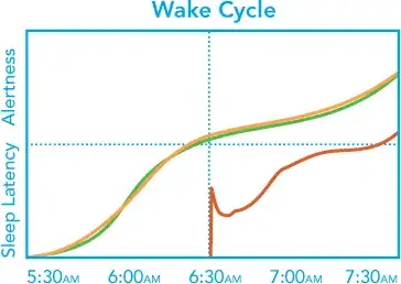

The transfer function of a commercial Sunrise alarm clock with brightness & alertness vs alarm time. Brightness need not be full when waking up, to give time for eyes to respond. An hour may be too long for most workers.
This a modified S curve.
