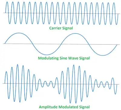

For example: when designing a silly amplitude modulation (AM) circuit that puts a square wave from a microcontroller in to an antenna, how are harmonics generated? The signal is just "on" or "off", how are there first, third, and fifth harmonics and why do they get weaker?

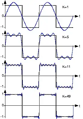

This is a partial construction of a square wave. The blue sine which shows 1 period is the fundamental. Then there's the third harmonic (square waves don't have even harmonics), the purple one. Its amplitude is 1/3 of the fundamental, and you can see it's three times the fundamental's frequency, because it shows 3 periods. Same for the fifth harmonic (brown). Amplitude is 1/5 of the fundamental and it shows 5 periods. Adding these gives the green curve. This is not yet a good square wave, but you already see the steep edges, and the wavy horizontal line will ultimately become completely horizontal if we add more harmonics. So this is how you will see a square wave on the scope if only up to the fifth harmonic are shown. This is really the minimum, for a better reconstruction you'll need more harmonics.
Like every non-sinusoidal signal the AM modulated signal will create harmonics. Fourier proved that every repeating signal can be deconstructed into a fundamental (same frequency as the wave form), and harmonics which have frequencies that are multiples of the fundamental. It even applies to non-repeating waveforms. So even if you don't readily see what they would look like, the analysis is always possible.
This is a basic AM signal, and the modulated signal is the product of the carrier and the baseband signal. Now
\$ sin(f_C) \cdot sin(f_M) = \dfrac{cos(f_C - f_M) - cos(f_C + f_M)}{2} \$
So you can see that even a product of sines can be expressed as the sum of sines, that's both cosines (the harmonics can have their phase shifted, in this case by 90°). The frequencies \$(f_C - f_M)\$ and \$(f_C + f_M)\$ are the sidebands left and right of the carrier frequency \$f_C\$.
Even if your baseband signal is a more complex looking signal you can break the modulated signal apart in separate sines.

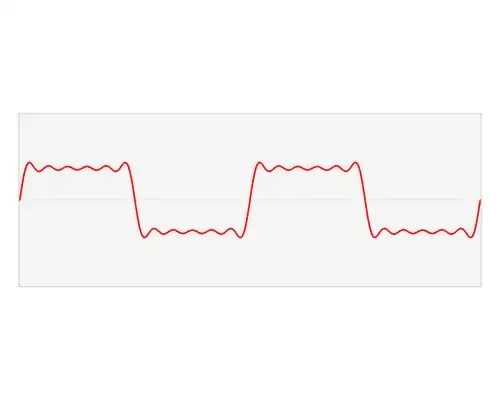

There is a beautiful animation by LucasVB explaining the Fourier decomposition of a square wave:
These images explain better the square wave decomposition in harmonics:
