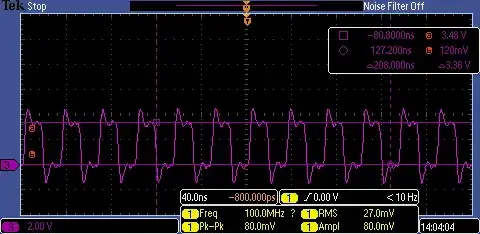

When I probe this signal with my oscilloscope, I get a distorted waveform which over shoots and undershoots. The probes I am using are the standard tektronics probes that come with the MSO2024B that we have. They have been calibrated to the scopes 5khz test point and show no overshoot.
Distored 30MHz Clock Signal
The clock signal should be 3.3V peak to peak.
The scope probe ground clip is connected to the 0V reference point near the regulator for the 3v3 rail.

    Seems like a pretty standard waveform when you don't probe propperly. A clock waveform should be probed with the spring ground clip of a probe connecting to the ground of the clock (which shouldn't be to far away in the first place). The loop area of those clip-type probes is simply too large to allow proper probing of the high-frequency components of a 30MHz clock signal. – Joren Vaes Oct 12 '17 at 15:05

There are two issues here: Bandwidth and Measurement technique.

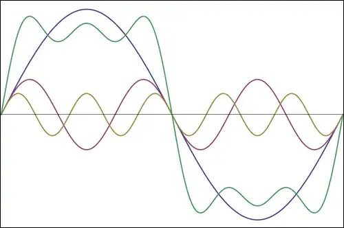

Bandwidth: Your measured signal is bandwidth limited. A 30MHz square wave has lots of harmonic content and your scope has a relatively low bandwidth (200MHz) so the higher frequencies are attenuated and you only see the sum of the first few odd-order harmonics (30MHz, 90MHz, 150MHz, ...).
Here is a square wave approximation made up of the 1st, 3rd, and 5th harmonics (taken from this question which looks quite a bit like the trace you posted: square wave approximation

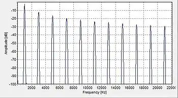

The fourier transform
Brief introduction: https://en.wikipedia.org/wiki/Square_wave#Fourier_analysis
30 Mhz square signal contains lots of higher frequency sine signals -even the 30 Mhz one!- to make the original square signal. This is an example extracted from wikipedia:
Fourier transform of a square wave
The image represents a part of the spectrum of the input signal. The entire spectrum is infinty.
Well, your signal is not at 1 KHz, but you can multiplying it 30000 times and nailed it.
