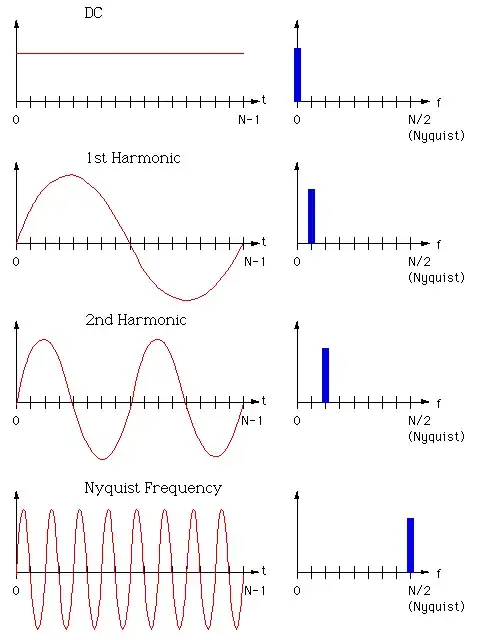

One point can be represented as a frequency, but the only thing we know about it is it has zero frequency or DC. If you want to actually sample a sine wave, you need more than one point, or the sine wave couldn't be re-created, there would not be enough information:
Sampling theorem
The sampling theorem (often called "Shannons Sampling Theorem") states that a continuous signal must be discretely sampled at least twice the frequency of the highest frequency in the signal.
More precisely, a continuous function f(t) is completely defined by samples every 1/fs (fs is the sample frequency) if the frequency spectrum F(f) is zero for f > fs/2. fs/2 is called the Nyquist frequency and places the limit on the minimum sampling frequency when digitizing a continuous signal.
Source: FFT\DFT enter image description here
So to answer your question:
How is a single voltage reading at a single moment in time able to correlate to so many different frequencies occurring at so many different levels happening at that single moment in time?
It can't, the sound processing software is probably using a trick to cut the waveform off before you see it or filling in information to get frequencies at T=0.
