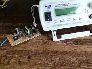

I actually own a FY3200S signal generator. When I bought it, I was already aware of the questionable quality of the switching power supply inside it, and the reported high earth leakage currents. For this reason, I replaced the built-in switch-mode power supply by a simple regulated linear power supply (a fairly common mod for these units). If you want to go this route, note that you'll need to provide +12V, -12V, and +5V.
I managed to find the original switch-mode PSU for the signal generator, so I hooked it back up, and took several measurements with both the original switcher and the new linear supply. I probably should have done that when I built the linear supply, but hey ¯\_(ツ)_/¯

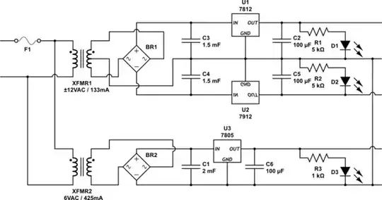

Power supply design
The linear power supply is very straightforward:
schematic
The LEDs aid debugging, and help ensure the rails are in regulation under no-load conditions. At the time I made this, I took measurements for the current requirements, but I forgot the results and can't find my notes on this project. The transformers are capable of 133mA (+12V and -12V each) and 425mA (+5V) respectively. I remember my design having not much headroom, so maybe these numbers help you.
The power supply circuit in your question looks acceptable to me (though I haven't run the numbers). It's similar, except it uses a single transformer and derives the +5V from the +12V rail. I would expect it to work just fine, just ensure the transformer can deliver enough current to power both the +12V and +5V on one leg. Research how to size the transformer and capacitors; there should be plenty of information out there on that subject. These answers may be a good starting point.

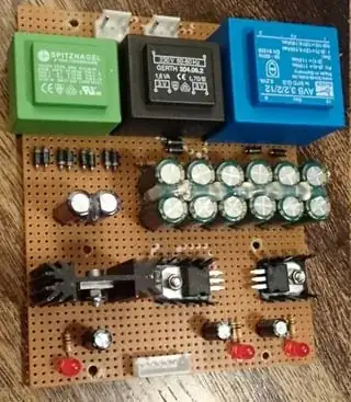

The implementation is messier than the schematic, because I had to make do with whatever parts I had laying around. In particular, the 5V rail is powered by two transformers that are paralleled after their bridges, and I had to use capacitors in series (with balancing resistors) on the ±12V rails to get the appropriate voltage rating (the rectified transformer output is like 24VDC to ground under no-load conditions).
Linear PSU top view Linear PSU bottom view

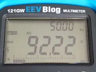

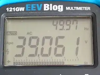

Earth leakage voltage
This is the heart of the question, and the most common reason to replace the PSU in these signal generators. It was measured by hooking up the oscilloscope or multimeter between my earth reference (central heating pipes) and the ground of the signal generator. The signal generator output signal itself (10Vpp 1kHz sine) was left unconnected.
Clearly, the linear PSU still has earth leakage due to capacitive coupling in the transformers and perhaps wiring, but it looks better than the switching PSU (both image 50V/div, 5ms/div):
Switching PSU ground-to-earth wave Linear PSU ground-to-earth wave
Multimeter measurements confirm that the open-circuit ground-to-earth voltage is indeed lower for the linear PSU (39VAC RMS) than the switching PSU (92VAC RMS):
Switching PSU ground-to-earth voltage Linear PSU ground-to-earth voltage

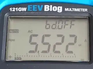

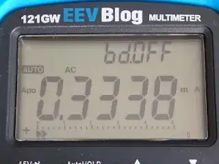

Earth leakage current
But the real difference is in the earth leakage current; at 5.5µA, I'm slightly disappointed in the linear PSU performance here, but it's two orders of magnitude better than the switching PSU at 334µA!

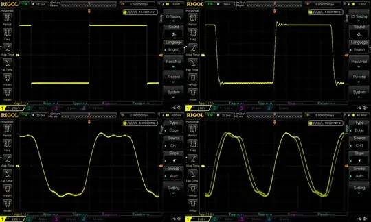

Signal quality at higher frequencies
In your latest edit, you added "... up to cca. 10MHz." Beware that these cheap signal generators are not great at higher frequencies. If you need, say, good square waves at 10MHz, you'll probably have to spend more money. I added some captures of the FY3200S 10Vpp square wave at 10kHz, 1MHz, 6MHz, and 10MHz:
FY3200S square waves at various frequencies
I'm not even sure what's going on at 10MHz. Perhaps the synthesizer frequency isn't evenly divisible by 10MHz, so not all square pulses are of equal length, leading to the ghosting you can see there.
Sine waves are easier, so they look considerably better, but at the higher frequencies they also show some small distortions.
